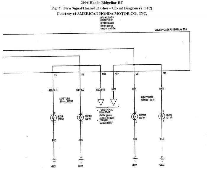

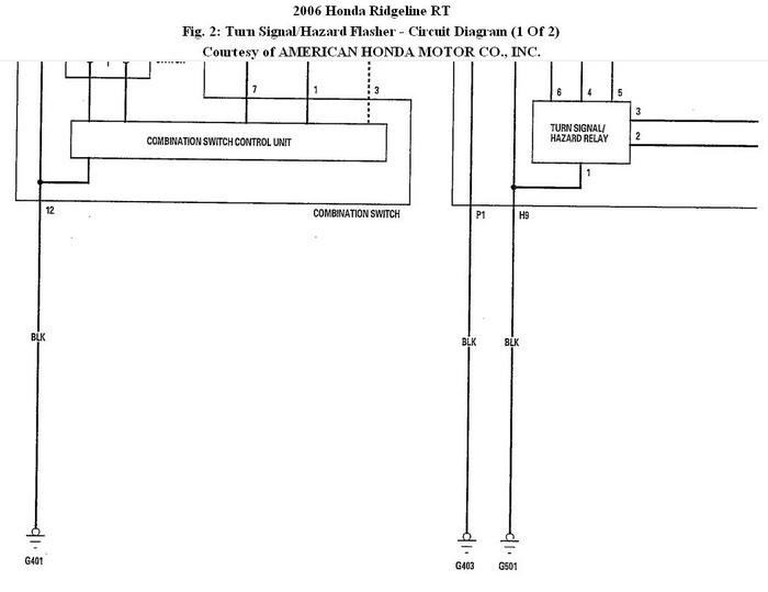

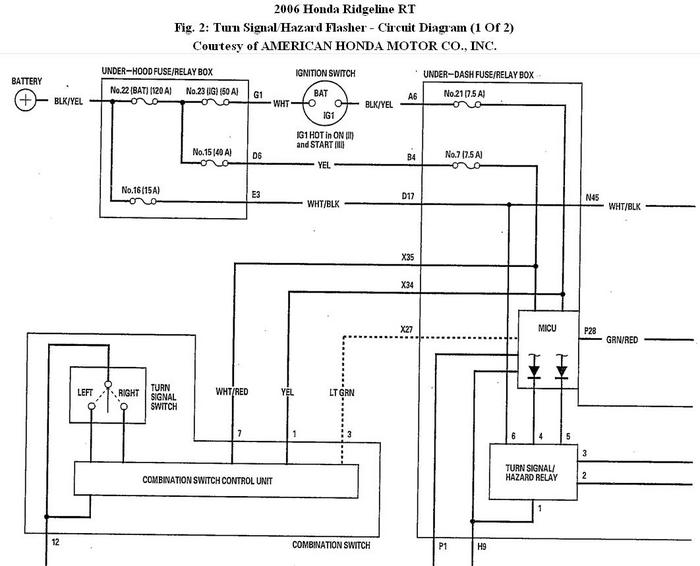

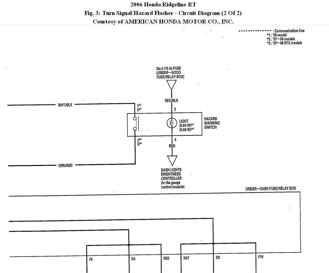

On my 2006 Honda Ridgeline, the turn signal and hazard lights blink erratically and stay constantly lit when the engine is off! I pulled the fuse to prevent battery failure but need to get my signals back...how?
Jan 3, 2020 at 8:18 AM (Merged)
KHLOW2008
  • 41,814 POSTS

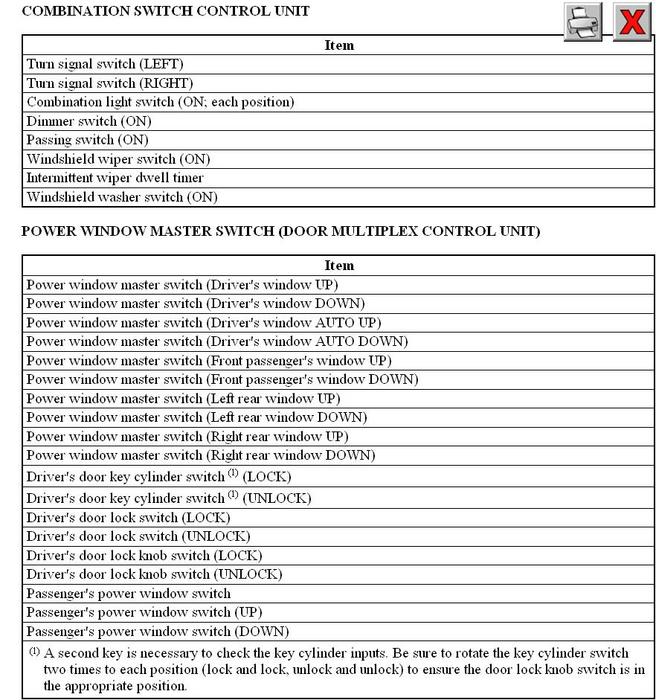

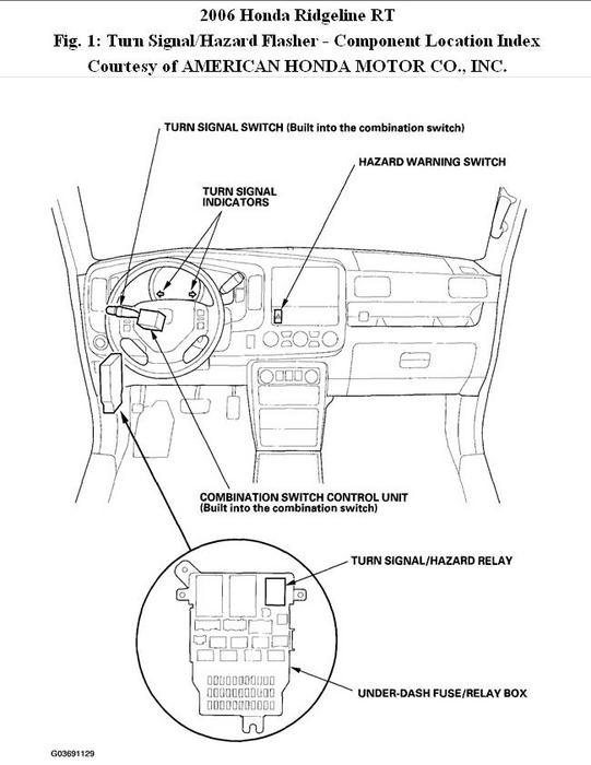

There are 3 things that can cause the problem :
1. Hazard switch.
2. Hazard flasher relay
3. MICU (Multiplex Integrated Control Unit)

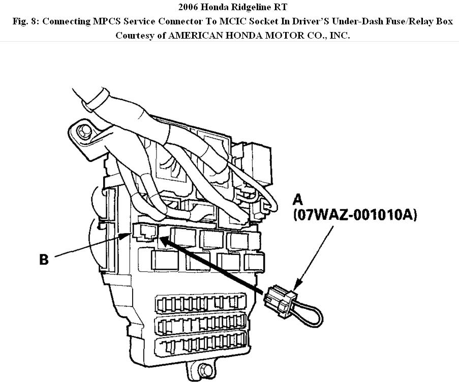

Perform the following to see if you can come up with anything.
TROUBLESHOOTING - B-CAN SYSTEM DIAGNOSIS TEST MODE 1 AND TEST MODE 2 (WITHOUT THE HDS)
Special Tools Required
MPCS (MCIC) service connector 07WAZ-001010A ( a jumper wire or paper clip would do)
TEST MODE 1
1. Check the No. 7 (7.5 A) fuse and No. 21 (7.5 A) fuse in the under-dash fuse/relay box.
Are the fuses OK?
YES - Go to step 2.
NO - Find and repair the cause of the blown fuse.
2. Remove the left kick panel.
3. Turn the ignition switch ON (II), and move the interior lights switch to the middle (door) position.
4. Connect the MPCS service connector (A) to the MCIC socket (B) in the driver's under-dash fuse/relay box.
5. Wait 5 seconds, and watch the map lights. When the front and rear map lights flash quickly once, and then go off, the system is in Test Mode 1.

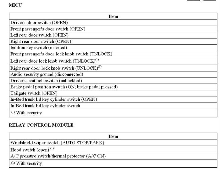

Test Mode 2

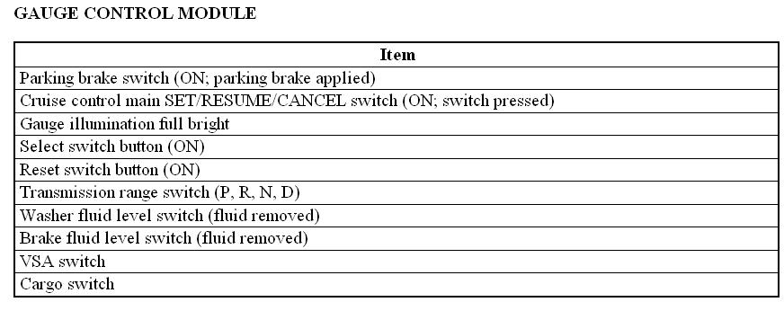

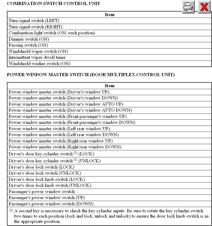

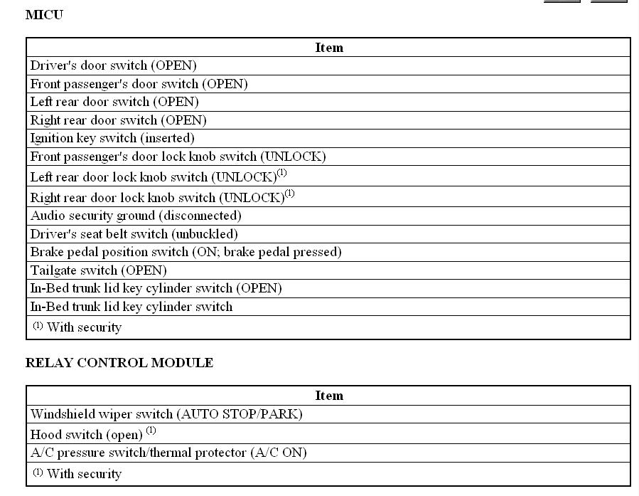

10. Remove the MPCS service connector from the driver's under-dash fuse/relay box socket for 5-10 seconds, then re-insert it to enter Mode 2. When the system enters Mode 2, the front and rear map lights will flash two times quickly and then go off.
NOTE:
If the MPCS connector is disconnected for too short or too long of a time, or the ignition switch is turned OFF, the system will return to Test Mode 1.
The following tables list the circuits that can be checked in Test Mode 2. Operate the switch that is most closely related to the problem. If the circuit is OK, the map lights will blink once. If the circuit is faulty, there will be no indication.
( Refer to chart )
Do the map lights indicate proper switch operation?
YES - Go to function and input test for the system related to the failure.
NO - Repair the open, short, or replace the faulty switch.
