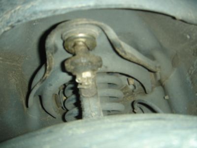

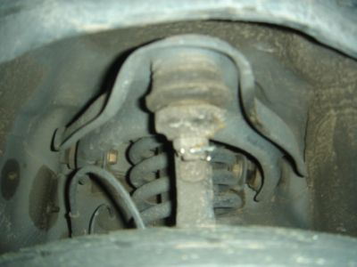

sorry being busy... so I went to autozone and got the code P0325 (Knock Sensor Circuit Malfunction) and P1324 (Knock Sensor Power Source Circuit Low Voltage) I had the knock sensor replace! The tail lights are still not working and now they tell I need a upper ball joint needs to be replaced... I called my local honda dealer it's $88 just to look at each issue... autozone told me I have to buy the entire control arm for about $200 dollars and have a professional install it... any recommended shops in houston, tx. Or could I go down to a junk yard and get one for cheap and install it my self... Thank You.. for you time and help... this is the one that has to be replaced
https://images.2carpros.com/forum/automotive_pictures/64505_passanger_side_1.jpg
here's the other one
https://images.2carpros.com/forum/automotive_pictures/64505_driver_side_1.jpg

Did you take the boot off the one? I hope they did not base replacement on the lack of a boot.
