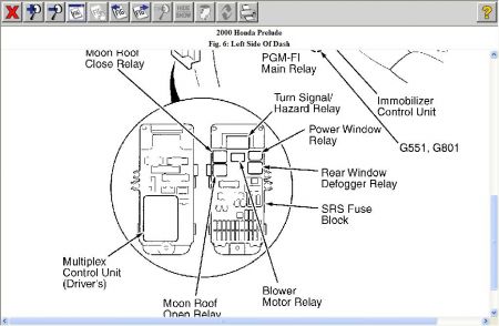

I think my srs relay melted with the plug, so I am unable to wire the new one up, at least i think its my srs relay,its located on the driver side floor next to the fuse panel, the relay is spring loaded and has 4 wires going to it, can you tell me what wire goes were, the chilton manuel does not show it

Hi the dog house, Thank nyou for the donation. I am not sure which relay you are refering to and I have attached a diagram for you to refer. The SRS don't use any relay and should not be as the voltage is not very high so won't cause the overheating of the relay.

Please let me know which one and I will get the wire color codes for you.

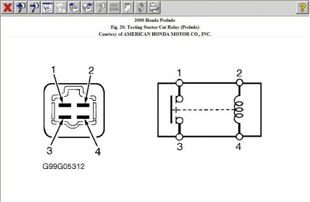

Bob and KEN, I am sorry I did not explain all,The relay smoked bad, I cut the wires to it and then the srs light came on, thats why I thought it was a srs relay, but its a power accessary relay with 4 connectors on it, that was laying right next to the fuse box inside the car on the driver side of the car, the plug that went to the relay melted, I was able to get a new relay, but unsure where the four wires go???

Is the relay found in the diagram above?

Hey guys , neither diagram shows that relay, yes and looking further into this my fog lights and viper alarm is not working,remote starter is not working ,eveything else works, so I am thinking that this is a power accessory relay,how would that wire up?

Hey Guys,Its a 4 pin relay,advanced auto part# r6069,,oem# is 39797-seo-004, their are 5 wires, all 5 are the same size,2 blacks with 2 brown markings on each wire(tabs or dots) a white with no markings,orange with 2 silver tabs, red&yellow with 1 silver tab,thats all wiring going to relay,the only things not working is the alarm, added on flood lights and the srs light is on and will not reset, can u guys help??

Hi, Well, seems we have a different situation now. It could possibly be the spot lights instead of the auto starter. The SRS light showing might be a different problem which you need to scan to find out what is wrong. Relay wires. Black = Body ground, both should be attached together. White = Battery power supply. Orange = To flood lights Red/Yellow = From floodlight switch. These are based on normal Honda color codes for wires and not confirmed to be correct as yours is add on. You need to test and confirm if they are correct. Use a test lamp, ground to body and test each wire for power supply. Attach the test lamp to the wire that has power supply and use it to connect other wires to find the ground wire. From the diagram, Pin # 1 = Constant power supply Pin # 3 = To flood light Pin # 2 = From control switch Pin # 4 = Ground.

Thanks for getting back with me, all looks great but,i have that 5th wire, black unsure were it goes?

Hey Guys I see what ur saying put the 2 blacks together, I am blind sorry, my Dad just had a heart attack today so I wont try this for a few days, but ill let ya know if it works or not, thanks for everything

Yes, both blacks should be spliced together.

Guys that was it, now I am working on getting my srs light to reset, any ideas ??
