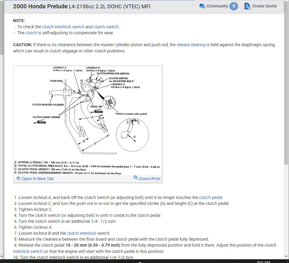

I just noticed when most of the time i engaged the clutch(pedal released) the clutch pedal doesnt fully go up to its original possition. I have to pull it up. It doesnt get stuck to the floor. Its during the free play area. I mean it does pop back up and i can still drive it. I dont feel the clutch slipping. I did notice a drop of clutch fluid coming out from the Master cylinder from the inside under the clutch pedal. The fluid is still full. And when I wipped it out. I never saw a drop again Its been over a week. And I drive it normally everyday. I think the Master Cylinder seal is broken. Or is there a air pocket in the lines. Should I bleed/flush the clutch fluid. Replace it? I dont want it getting worse. I want to make sure its getting enough hydraulic pressure when applied.
And My cruise control just stopped working. Could it be related?

More than likely you are exactly correct with the master cylinder issue.
However, I don't think bleeding the clutch will make a difference. Bleeding the clutch will only help if the clutch has air in it and this is a mechanical issue as the clutch pedal return is not an issue caused by air. That issue is when you press the clutch and do not get full disengagement.
Here are a couple guides that will help with this as well:
https://www.2carpros.com/articles/clutch-doesnt-work-sometimes-or-not-at-all

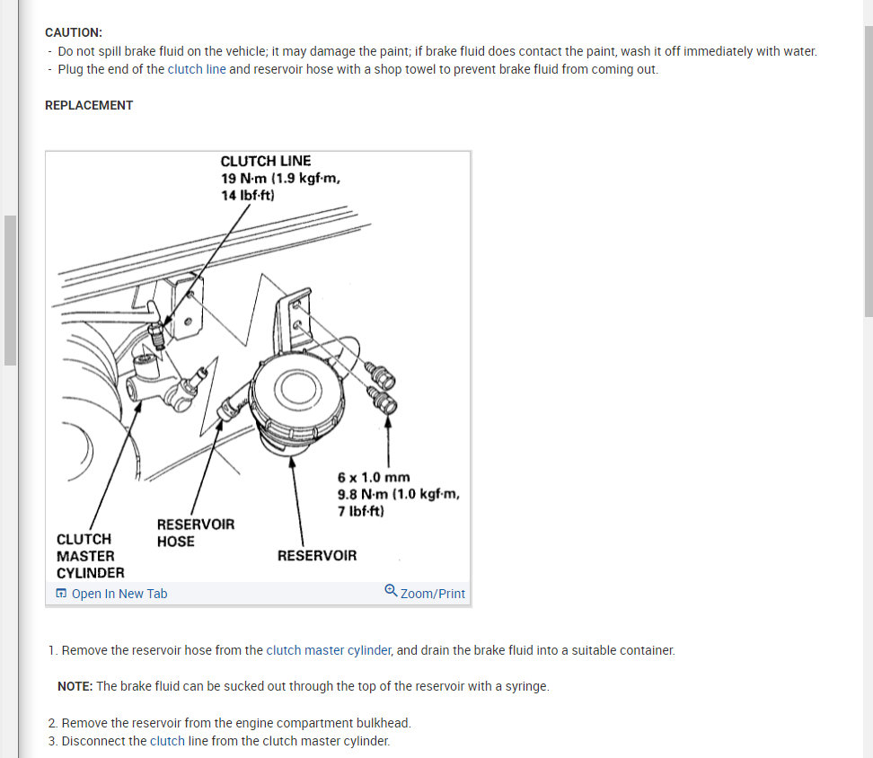

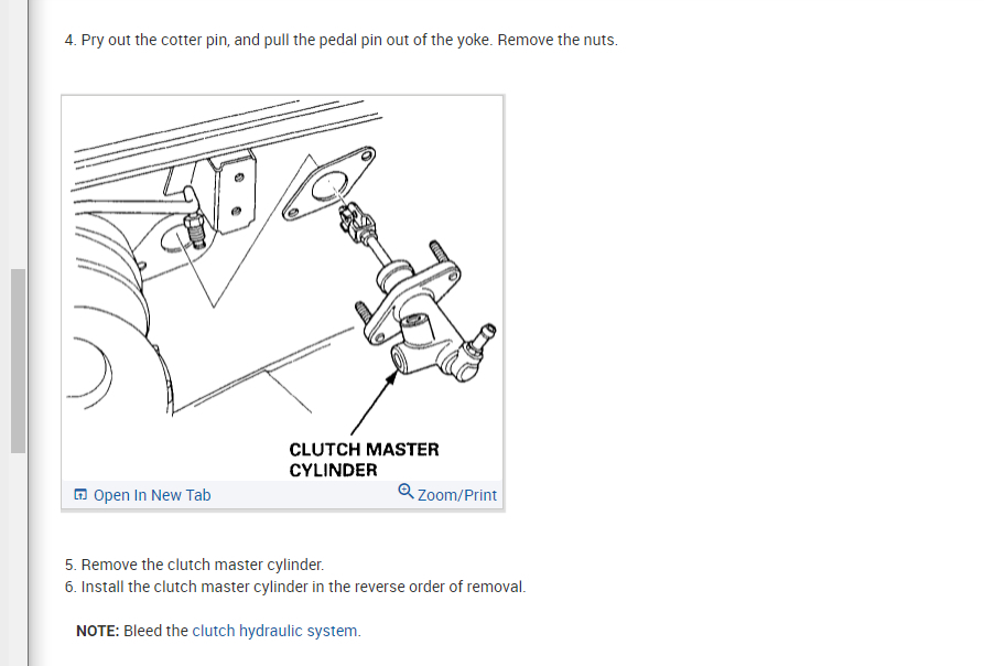

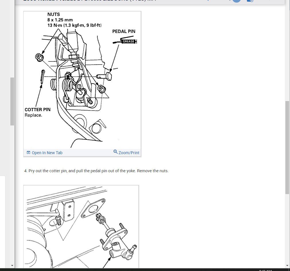

One thing to try before replacing the clutch is to adjust the pedal and master with the process below.
I also included the replacement process for your review.
Please run through this and let us know if you have questions. Thanks.
