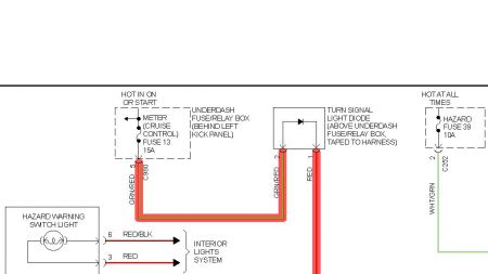

'98 Honda Prelude. Turn signals won't flash when using the column switch. Hazard switch works all lights normally. Checked ALL fuses. Replaced 6 prong flasher relay in driver's footwell (Part #FR-3501). Replaced column switch. No alteration of car's wiring for several years. No accidents or body work done. Turn signals just quit working all of a sudden. I'm stumped. Any help would be appreciated.
Aug 25, 2008 at 5:00 PM
  • 75,992 POSTS
Put key in run-At the turn signal switch look for power at the red wire-nothing there check below Check fuse no.13 15amp and the turn signal light diode-see below
https://images.2carpros.com/forum/automotive_pictures/12900_turn_signal_3.jpg

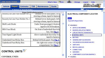

Where in the 1998 Honda Prelude is the turn signal light diode located? Thanks!
Aug 25, 2008 at 7:22 PM
  • 75,992 POSTS
Sir the diode is above underdash fuse/relay box tape to the harness.No picture available
https://images.2carpros.com/forum/automotive_pictures/12900_diode_1.jpg
Aug 25, 2008 at 9:59 PM
LAMSON1
Extreme thanks for your diagnosis. Wire to the diode was broken! Now I can feel safe changing lanes again. Have a great day... I sure will!
