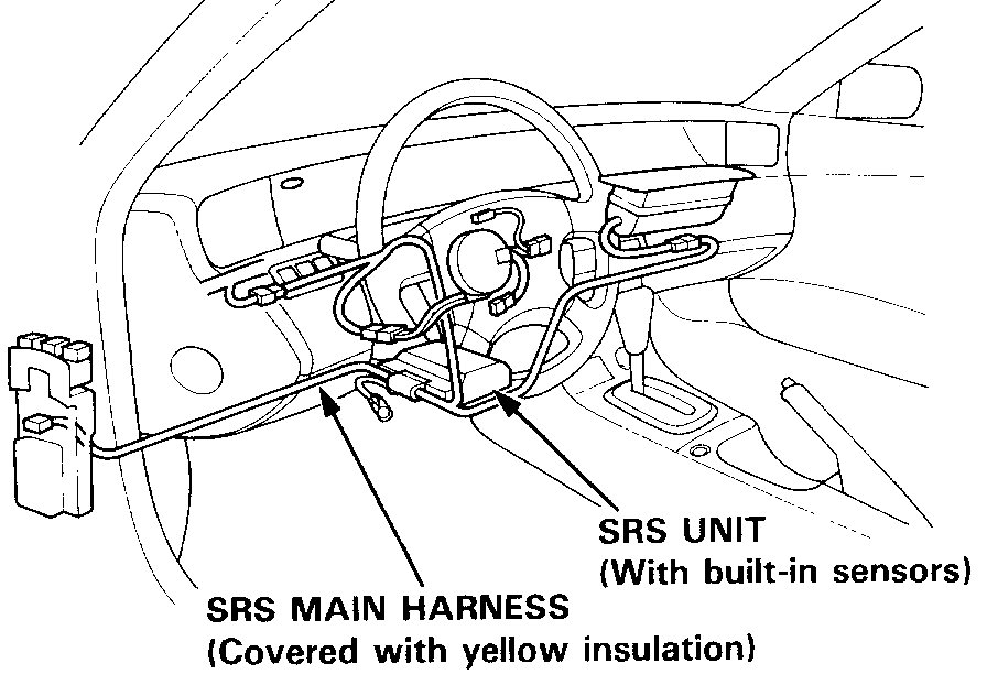

The blower motor is under the dash on the passenger side of the vehicle. See pic 1.
What you described sounds like the motor itself is going bad.

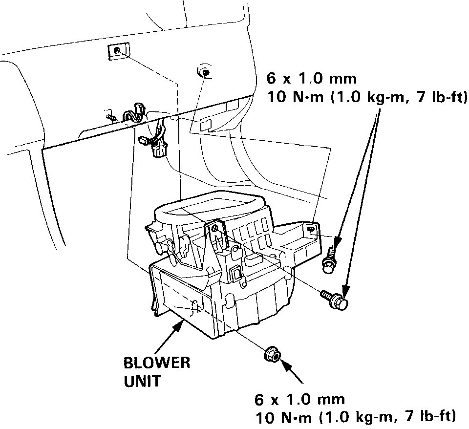

Here are the directions specific to your vehicle. The remaining pictures correlate with the directions.
___________________________________________________________
1995 Honda Prelude L4-2.2L SOHC
Removal and Installation
Vehicle Heating and Air Conditioning Blower Motor Service and Repair Procedures Blower Unit Removal and Installation
REMOVAL AND INSTALLATION
Blower Unit Replacement
pic 2

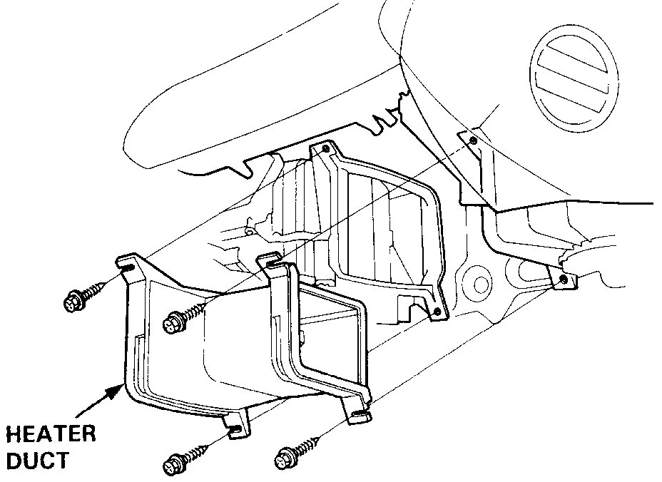

WITHOUT AIR CONDITIONING
pic 3
2a. Remove the four self-tapping screws and the heater duct.

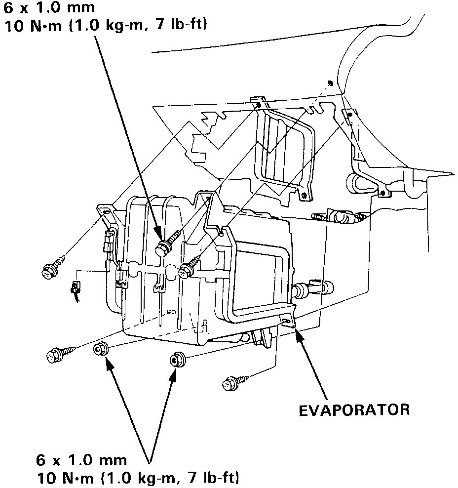

WITH AIR CONDITIONING
pic 4
2b. Remove the evaporator.

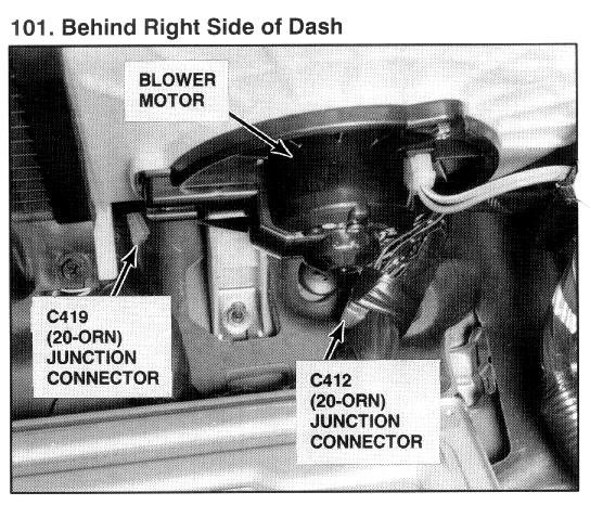

3. Disconnect the connectors from the blower motor, blower resistor, and re-circulation control motor.
pic 5
4. Remove the two bolts, nut and blower unit.
5. Install in the reverse order of removal, and make sure there are no air leaks.
