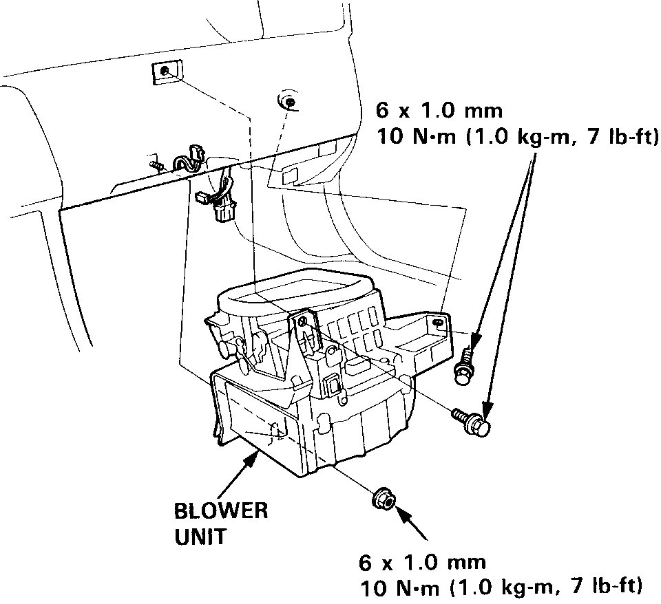

my air conditioner will only start blowing if i hit a bump and it catches the front end and jars the car, then it starts blowing, same way with the heater, and if i am going about 50 or higher cold air will seep in through the vents. what could cause this and where is the blower located in my car so i can check it?

Hi coreysimpson,
The blower motor, located under the glove box to the far end of the dash is failing and is time for a replacement.
The carbon brushes are running out and vibrations would allow the brushes to come into contact and make the blower work.

The blower motor is under the dash on the passenger side of the vehicle. See pic 1.
What you described sounds like a loose connection or the motor itself is going bad. What to do is this. Locate the blower motor. Turn the fan on and move the wiring around on the connector at the motor. If nothing changes, tap on the motor itself and see if it starts working.

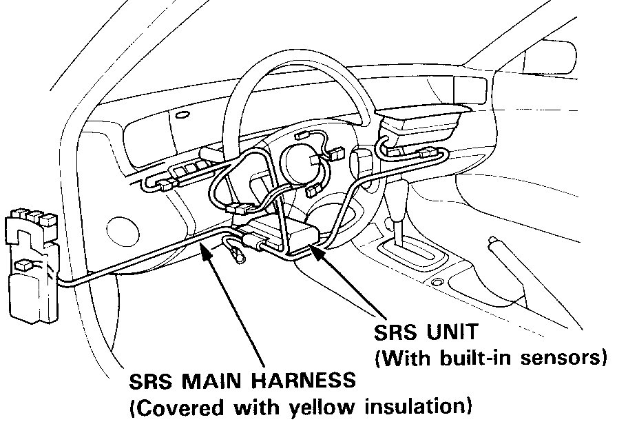

pic 2
CAUTION:
- All SRS wire harnesses are covered with yellow insulation. Before you disconnect any part of an SRS wire harness, connect the short connectors.
- Whenever the ignition switch is ON (II), or has been turned OFF for less than three minutes, be careful not to bump the SRS unit; the airbags could accidentally deploy and cause damage or injuries.

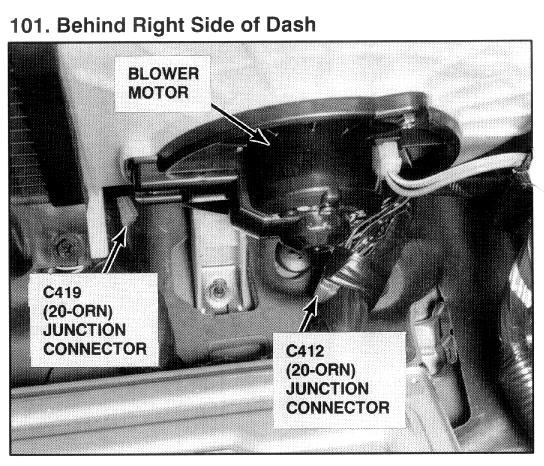

pic 3
2a. Remove the four self-tapping screws and the heater duct.

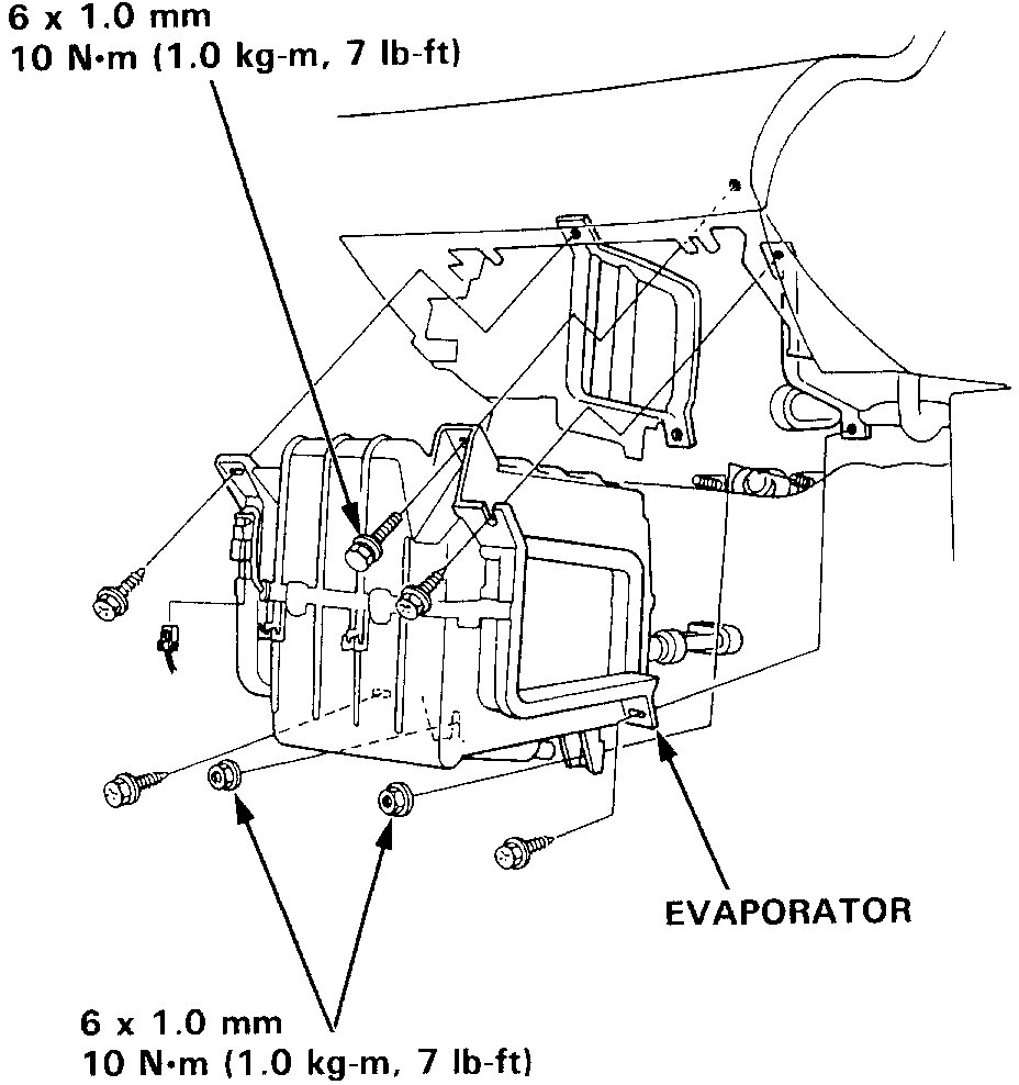

WITH AIR CONDITIONING
pic 4
2b. Remove the evaporator.
3. Disconnect the connectors from the blower motor, blower resistor, and re-circulation control motor.

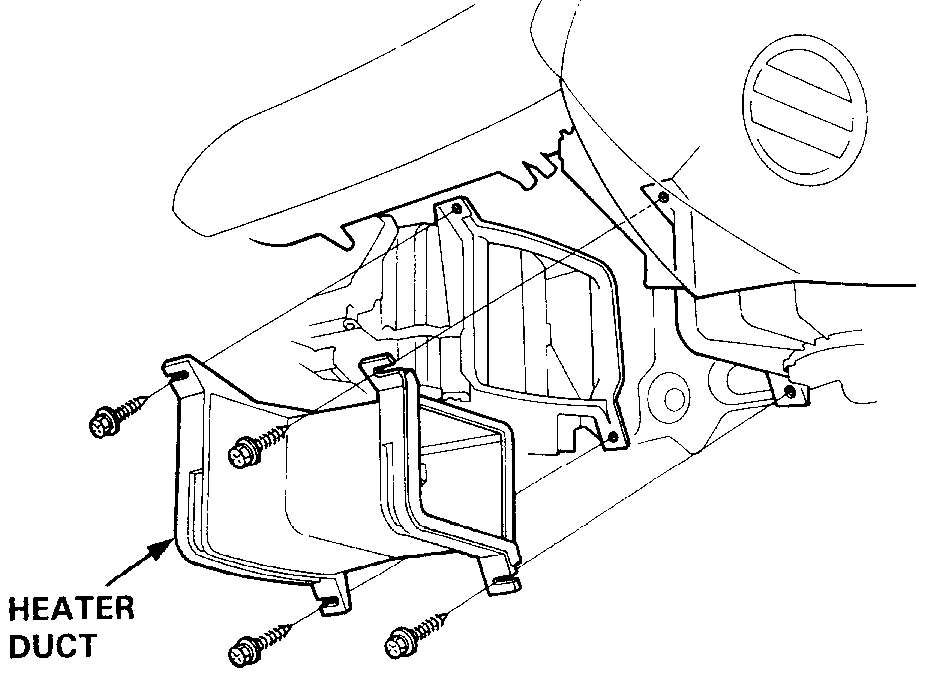

pic 5
4. Remove the two bolts, nut and blower unit.
5. Install in the reverse order of removal, and make sure there are no air leaks.
