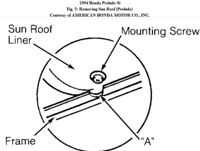

i want to replace the metal sunroof honda prelude 1994 wit sheet metal ive already cut the sheet metal i just need to know how to take sunroof apart

Hi jaymoultimo, Our database does not have a good description nor pictures of the sun roof removal procedures. Hope the following is sufficient. Removal & Installation Remove front roof trim. Align position "A" of frame to mounting screw.
https://images.2carpros.com/forum/automotive_pictures/192750_SunRoof94PreludeFig05_2.jpg
Remove mounting screws and clips. Slide sun roof slightly forward. Taking care not scratch sun roof liner, slide from under sun roof and remove it. Remove mounting screws from panel brackets on both sides. Lift up and remove sun roof panel. To install, reverse removal procedure.
