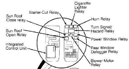

There is an integrated control unit next to the fuse box, but if the tail and parking lights are out, suspect a wiring problem...
https://images.2carpros.com/forum/automotive_pictures/62217_hona_1.jpg
I am having trouble uploading pictures right now, I will try again later. But the control unit does the flashers, oil pressure warning and other stuff, if these work I think it's wire or fuse related.

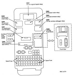

FUSE PANEL LOCATION Fuse box is located under dashboard on driver's side. Underhood relay panel is located on right side of engine compartment next to battery. A list of protected circuits and fuse ratings for each is found on a chart inside fuse box and on fuse panel cover. UNDERDASH FUSE PANEL IDENTIFICATION (1992-95) Fig. 1: Underdash Fuse Panel Identification (1992-95) Courtesy of AMERICAN HONDA MOTOR CO., INC.  1 - Not Used  2 - 7.5 Amp PGM-FI ECM, PGM-FI Main Relay, Starter Signal, Sub Gauge (Brake Check Circuit)  3 - 15 Amp Front Foglights (Option)  4 - 10 Amp PGM-FI Main Relay  5 - Not Used  6 - 15 Amp Seat Heater System (Canada)  7 - 30 Amp Sun Roof Open Relay, Sun Roof Close Relay  8 - 10 Amp Daytime Running Lights Control Unit (Canada)  9 - 15 Amp Heater Control Panel, Power Mirror System, ABS Control Unit, 4WS Control Unit, Fan Timer Unit, Mode/Recirc. Control Motor Heated Mirrors (Canada)  10 - Not Used  11 - 10 Amp Seat Heater Main Relay (Canada), A/C Compressor Clutch Relay, PGM-FI, ECU, Rear Window Defogger Relay  12 - 7.5 Amp Daytime Running Lights (Canada)  13 - 10 Amp Gauge Lights, Indicator Lights, Clock, Back-Up Lights  14 - 7.5 Amp Cruise Control System  15 - 20 Amp Driver's Power Window System  16 - 20 Amp Passenger's Power Window System  17 - 30 Amp Windshield Wiper System  18 - 10 Amp Stereo Radio/Cassette Player, Cigarette Lighter  19 - 15 Amp (Without SRS) (1992), Not Used (1993-94) PGM-FI Main Relay, A/T Control Unit, Fan Timer Unit, ELD Unit NOTE: Replacing a fuse with one of a greater rating greatly increases chances of damaging electrical system. If replacement fuse with proper rating for circuit is not available, install one with a lesser rating.  20 - Not Used  21 - Not Used  22 - 10 Amp 4WS Control Unit, 4WS Front & Rear Steering Angle Sensors  23 - 15 Amp SRS Unit, Transmission Control Module (TCM), PGM-FI, Radiator Fan Control Module, Vehicle Speed Sensor (VSS), Charging System  24 - 10 Amp SRS Unit UNDERHOOD FUSE & RELAY PANEL IDENTIFICATION (1992-94) Fig. 2: Underhood Fuse & Relay Panel Identification (1992-94) Courtesy of AMERICAN HONDA MOTOR CO., INC.  31 - 50 Amp ABS Motor Relay  32 - 100 Amp Power Distribution  33 - 50 Amp Ignition Switch (BAT)  34 - 40 Amp Rear Window Defogger Relay  35 - 40 Amp Blower Motor Relay  36 - 40 Amp Seat Heaters (Canada), PGM-FI Main Relay, Fog Lights (1994)  37 - 40 Amp Sun Roof System, Power Window System, Daytime Running Lights Control Unit (Canada)  38 - 60 Amp 4WS Control Unit  39 - 15 Amp Turn Signal/Hazard Relay, Hazard Lights  40 - 15 Amp ABS Control Unit (B2)  41 - 15 Amp Horns, Horn Relay (With SRS), Brakelights, Brakelight Signal  42 - 20 Amp Parking Lights, Dash Lights  43 - 10 Amp Clock, Stereo Sound System, 4WS Control Unit, Power Antenna ECM, A/T Control Unit (TCM), PGM-FI (1994)  44 - 15 Amp Power Door Lock Control Unit  45 - 15 Amp Condenser Fan Motor, Fan Timer Unit  46 - 15 Amp Ceiling Light, Cigarette Lighter Relay, Trunk Light, Ignition Key Light, Interlock System  47 - 15 Amp Radiator Fan Motor  48 - 7.5 Amp ABS Control Unit  49 - 20 Amp ABS Control Unit (B1)  50 - 20 Amp Right Headlight  51 - 20 Amp Left Headlight, High Beam Indicator Light, Fog Light Relay (1994) WARNING: Always disconnect battery ground cable before servicing "high- current fuses. It is recommended that "high-current" fuses be replaced by a qualified technician.

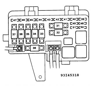

Step 1:LOCATE/TEST/REPLACE IF NECESSARY with a 20AMP fuse, FACTORY LOCATION FUSE NO. 42
(this fuse is located under the hood, toward the back of the ENGINE BAY [passenger side and to the back left side of the engine compartment], inside a black fuse box with a easily removable cover)
can also be located in the pictures/schematics posted by a previous responder
-I found that mine was fine-
