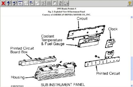

On my instrument panel the gas guage and thermostat are both digital. Nothing shows when i start my car. neither are working properly. i have checked for fuses both under the hood and under the steering column but failed to locate and instrument panel fuse. what should i do to get this to work?? answers are greatly appreciated :-)

Hi dylanh90,
# 13 (10A) fuse underdash.

I changed that fuse & it didn't do anything for the digiital fuel gauge. It still doesn't work

Hi dylanh90,
In that case you need to remove the meter cluster to test fpr power supply and grounding points.

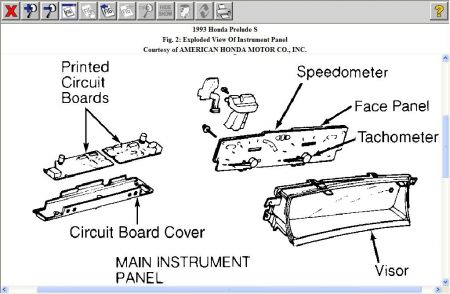

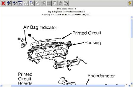

Ok, I have the same problem, fuel & temp gauges don't work. Fuse 13 has been tested and works. Where would I find the meter cluster?

https://images.2carpros.com/forum/automotive_pictures/192750_Meter93Prelude01_1.jpg
https://images.2carpros.com/forum/automotive_pictures/192750_Meter93Prelude02_1.jpg
https://images.2carpros.com/forum/automotive_pictures/192750_Meter93Prelude03_1.jpg
