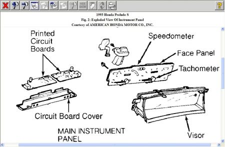

On my instrument panel the gas guage and thermostat are both digital. Nothing shows when i start my car. neither are working properly. i have checked for fuses both under the hood and under the steering column but failed to locate and instrument panel fuse. what should i do to get this to work?? answers are greatly appreciated :-)

# 13 (10A) fuse underdash.

I changed that fuse & it didn't do anything for the digiital fuel gauge. It still doesn't work

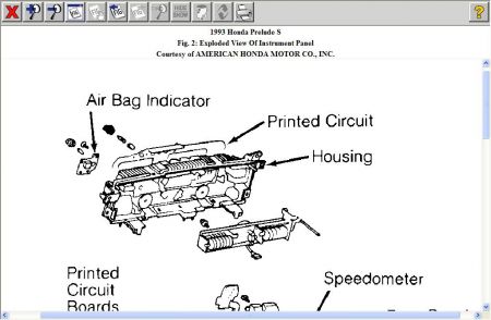

In that case you need to remove the meter cluster to test fpr power supply and grounding points.

Ok, I have the same problem, fuel & temp gauges don't work. Fuse 13 has been tested and works. Where would I find the meter cluster?
