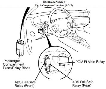

hi i have 93 honda prelude the problem is sometimes when i stop to stop sign or stop light the engine dies and the idle is so low i Idle Air Control Valve and Idle Control Unit. i already adjusted the idle but still not working. and some times the car wont start youl here the engine if you start the car but the car wont start

Hi 93hondapreludesi, Thank you for the donation. Did you clean the throttle body, idle adjust screw air passage and IAC? If yes, then I would recommend chaecking/adjusting the valve clearance. The difficult starting is most probably due to an intermittently failing PGM-FI main relay. Remove it and resolder the circuit board and retest.
https://images.2carpros.com/forum/automotive_pictures/192750_PGMFIRelay92Prelude_4.jpg
