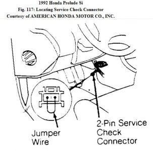

i cannot find the diagnostic port on my prelude import i have had another engine put in and the light is still on how do i turn it off

Hi big.z.786 It is behind the centre console, under radio on driver side.
