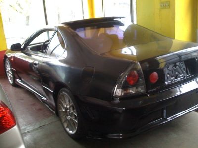

I scan my car using the obd code reader and it says code 12 (no EGR action). Whats happening in my car is even if i step on the gas it is just reving up but not speeding as much as i wanted to. I asked my mechanic and he says there could be a vacuum leak, transmission problem or timing belt wasnt put on properly or the egr valve as well.. I havent replace the fuel filter since i bought it about 4 months ago, would it help if i replace that too? i already replace the wire set, plugs, air filter... Help anyone???

DEVILLE_GUY
What about cap and rotor??? would it help too???

Mar 28, 2009 at 2:15 PM
KHLOW2008
  • 41,812 POSTS
Rotor and cap would cause misfiring and poor performance as well.
Before replacement of any parts, it would be best to check adjustments first to avoid unnecessary replacement of parts.
Check the ignition timing first.
