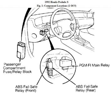

when car sits overnight, it dosent want to start. It cranks over and then it fires once, then smoke comes out of the intake. Has new fuel pump, fuel filter, distributor, spark plug wires. When started, runs great.

Hi jojogunns,
I would suggest checking the PGM-FI main relay.
https://www.2carpros.com/forum/automotive_pictures/192750_PGMFIRelay92Prelude_1.jpg
