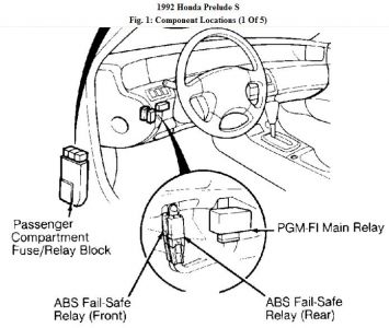

when i open ignition key there is no power to the fuel pump and i though it was the fuel pump but is working so i test the power line and there is no signal

Hi marco melgar, It usually is caused by a faulty PGM-FI main relay. Resoldering the circuit board helps.
https://images.2carpros.com/forum/automotive_pictures/192750_PGMFIRelay92Prelude_2.jpg
