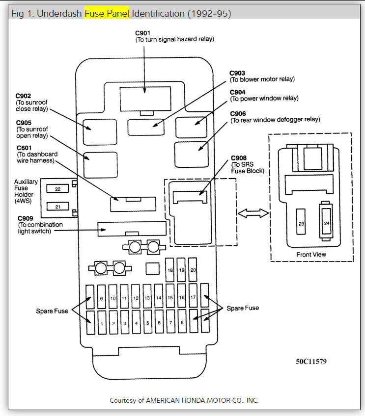

is there a fuel pressure solenoid before the relay and if so where is it. i have power at the fuel pump before start but after the initial few seconds it doesn't power up again
Mar 17, 2010 at 11:13 PM
  • 75,992 POSTS

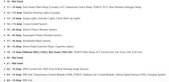

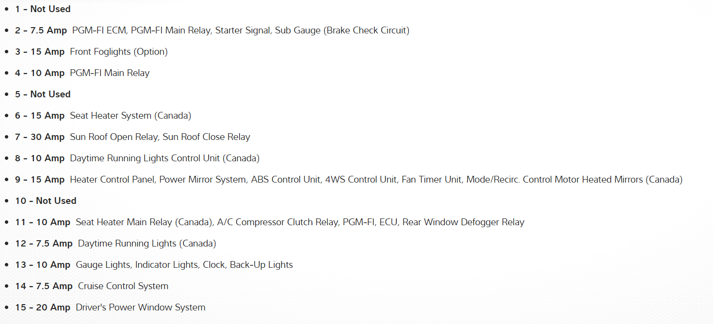

Inspect and test the PGM-FI Main relay it powers the fuel pump here is a guide and the relay location in the diagrams below.
Check out the diagrams (Below). Please let us know what you find. We are interested to see what it is.
