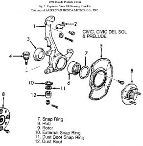

Three of my lug nuts on my front right tire broke and snapped off. I have 17 inch aero speed GT rims though. i need to know how do I fix them with wheel studs? the wheel studs are size M12-1.5.[img:61997a76c3]http://www.2carpros.com/forum/automotive_pictures/562080_34089_1410016492855_1305772822_31497179_5885673_n_1.jpg[/img:61997a76c3]

Hi tneal200, Jack up front of vehicle and put on stand. Remove the tire. Remove the brake caliper and mount. Remove the brake rotor. Remove CV joint central nut. Pull hub slightly out to enable the lug to be removed. Knock the lug in to remove. Use the wheel nut to pull the new stud into position. Be careful not to damage the wheel nuts.
https://images.2carpros.com/forum/automotive_pictures/192750_FrtHub91PreludeFig02_1.jpg
