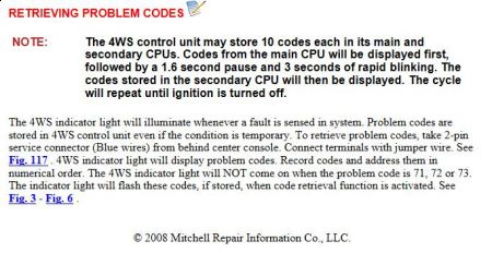

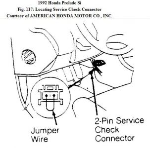

4 wheel steering light has come on and 4 wheel steering is no longer working, just driving like a normal car - engine light not on though? could it be electrics? any suggestions on what problem could possible be...and how to fix it!!

Hi jo-jo-7, You need to retrieve the Diagnostic Trouble Code to find out what is wrong. Quite often the problem is caused by sensor faults. Was any alignment or wheel, steering related jobs done recently?
