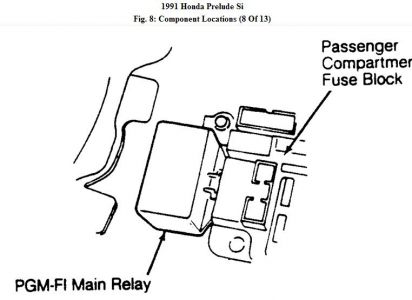

Engine rotates but won't start let sit for an hour engine starts fine.

Symptoms seems to indicate a common occurrence, a fault with the PGM-FI main relay. Remove it and resolder the circuit board to see if it helps.
