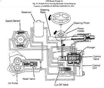

Here is a description of the system.
DESCRIPTION
The power steering system is rack and pinion type. Power assistance is proportional to both vehicle speed and steering load. The power assist is high when vehicle speed is low, and low when vehicle speed increases.
The speed sensor is a trochoid-rotor hydraulic pump that is driven by a speedometer gear in the transmission. When the vehicle is in motion the speed sensor pump relieves a portion of the hydraulic pressure which reduces the amount of power assist to the steering. System consists of a power rack and pinion steering gear, steering pump, fluid filter/reservoir, control unit, vehicle speed sensor, cooler lines and hoses.
The PS fluid is leaking past the VSS into the trans and this part is non serviceable. A replacement is necessary.
I only managed to get a circuit diagram of the system and hope it is helpful.
https://www.2carpros.com/forum/automotive_pictures/192750_SteeringHydraulicCircuit89PreludeFig12_1.jpg

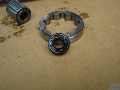

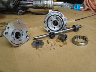

Well all I can say is,, I must have gotten lucky, thanks to you guys. You definately pointed me in the right direction . Thanks for that! I checked with the dealer and found that to replace the sensor would cost $248. So I deciced to just go and do what I was going to do any way. Not being able to locate a used one I took mine apart , it literally fell apart, couldn't have been easier. I was able to acquire a replacement seal and VOILA, The seal dimensions are 16mmx8mmx7mm. I just have to re-install the sensor back into the car in the morning. The lower seal was definately shot. It's been leaking for a while but my attention wasn't brought to it until I replaced the rack and pinion which had been leaking from both sides for quite a while.

Here's a closer look at the seal

Good for you and glad you have solved the problem.
