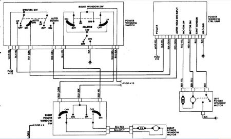

none of the electric windows will work the fuses are good and the window switches and the window motors are good but there isn't any power getting to any of them. wanted to know how i can get a wiring diagram for all the wires that go to the window motors to see were the faulty wire or connector is. i bought a book for it but it doesnt show any wiring diagrams for the windows.

Hi dale leal, Here is a schematic of the power window. Hope it is helpful.
https://images.2carpros.com/forum/automotive_pictures/192750_PWSchematic87Prelude_1.jpg
