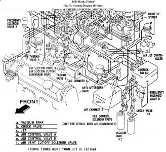

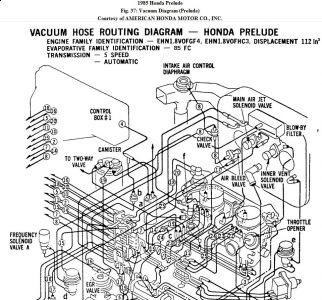

Please advise I removed the alternator and to get to it I removed the air filter and a few hoses. I thought I plugged them all back up but when i cranked the car there was light blue smoke coming from the tail pipe and when I mashed the gas it almost cut off. Please help.. I noticed there are 2 ports on the outside of the air filter cover located under the right carb on the outside of the air filter house.I see a hose for one of them and i connected it but i don't see a hose for the other port that's right underneath it. Is there suppose to be a hose? What else could it be the car drove perfect before I changes the alternator.. Thanks

Hi there, Hope the following diagrams are helpful.
https://images.2carpros.com/forum/automotive_pictures/192750_Vacumn85PreludeFig37a_1.jpg
https://images.2carpros.com/forum/automotive_pictures/192750_Vacumn85PreludeFig37b_1.jpg

OMG thanks so much... I see the ports and this has made it so CLEAR. THANKS SO MUCH FOR YOUR MUCH NEEDED HELP!!!!
