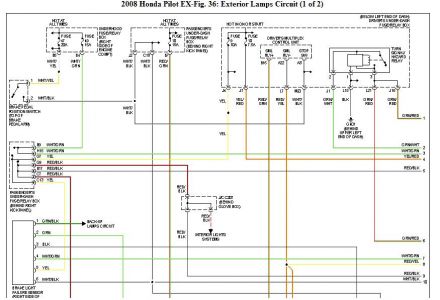

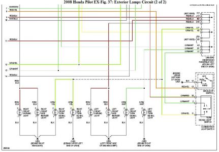

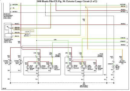

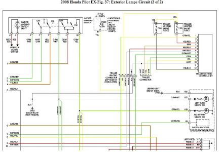

I would like to know how to wire in a 4 way wiring harness into a new 2009 Honda Pilot? I really don't want to pay what they want for a harness at the dealer.
Thanks
Yac
Mar 25, 2009 at 4:20 PM
KHLOW2008
  • 41,814 POSTS
Hi Yac, Your model is too new and I do not have the necessary info available. However I have attached a 08 model for your understanding of the system and the wire colors should be similar. Please take note that any unauthorised alteration/tampering of the system can void your warranty.
