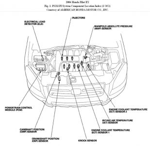

23-01 knock sensor 1, no signal. Which sensor does this refer to?

P0001 = Fule volume control circuit/open.
Vehicle is only equipped with one knock sensor.
The intake manifold has to be removed to gain access.
