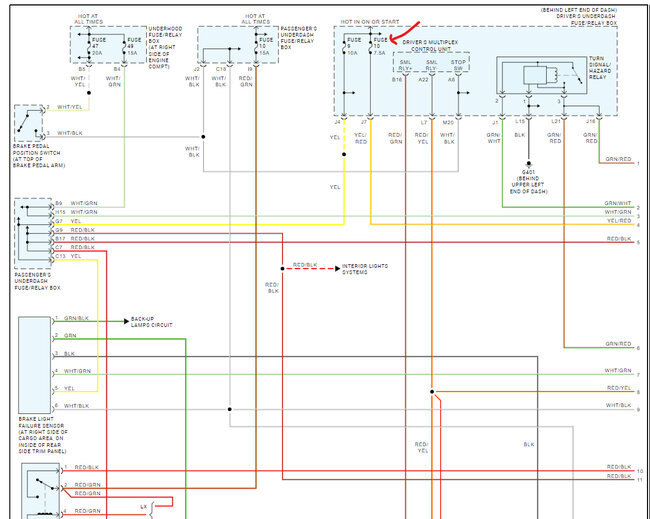

LT/RT signals at trailer connector stopped working.
Tail lights work OK. I'm using a small testor/plug that has lights that illuminate when that light is selected.
I was testing and - ultimately - replaced the wiring harness on my utility trailer when, during the process, those lights stopped working. They work ok on the car.
I have the Mitchell1 wiring diagram which shows a trailer lighting control unit. Where is this and is it accessable to me - or do I need to get at it at all?

Can somebody locate for me the "trailer lighting control unit" shown on pg. 2 of the exterior lamps circuit (Mitchell 1 on-line Manual) of my '04 Pilot? That and the in-line fuses locations are not described on the diagram page.

I solved the problem and will share.
In my case, it wasn't the wiring harness, it was the right brake light/turn signal circuit in the light assembly itself (it looked fine--no corrosion, etc.). It blew one of the in-line fuses (7.5 amp) in the trailer wiring circuit. These can be easily located underneath the rear trim panel that is between the cargo box and the back of the car. They will release if you pull up on the panel carefully, as will the four "hooks" that attach to the back of the cargo box. (Remove the cargo lid first, just open then lift up.)The in-line fuses(2) are in that white connector- like box next to the trailer lighting control unit. Slip off the control unit cover that attaches to the back of the cargo box and remove the bracket that holds the unit in place (hex-head machine screw)for easier access to the wires.

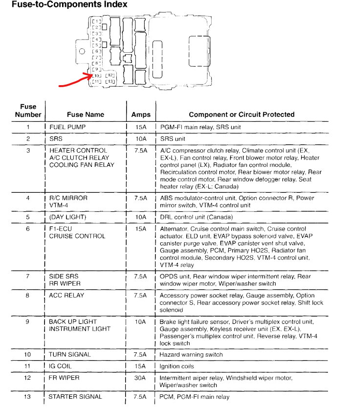

DNTELLIS2 can you upload a picture of the fuse location?

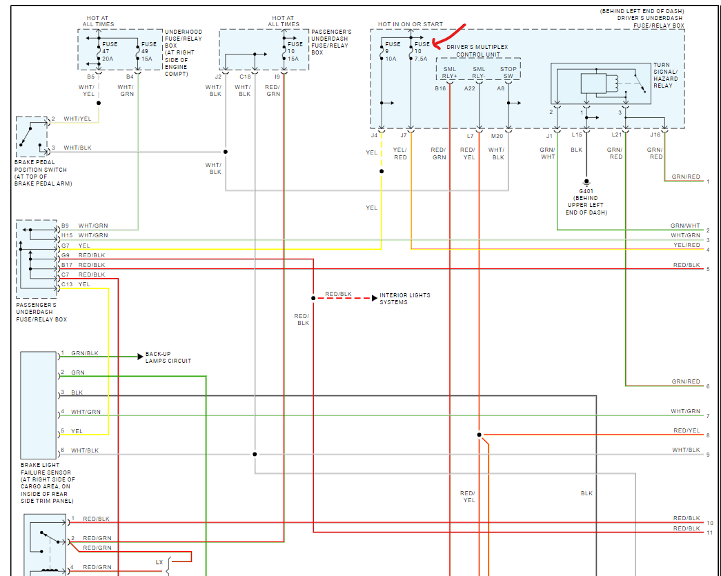

Sure, here is the fuse in question which is in the fuse panel inside the car on the drivers side. Check out the images (below). Please let us know what happens.
