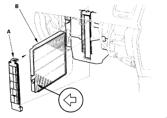

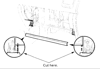

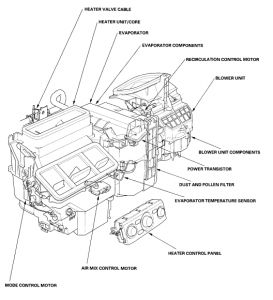

Can you help me identify the location of my cabin filter in my 2004 Honda Pilot. It does not appear to be located behind the glove box. Thanks, Marcus

Heating And Air Conditioning Component Location Index
https://images.2carpros.com/forum/automotive_pictures/12900_cf_2.jpg

2.Cut the plastic cross brace in the glove box opening with diagonal cutters in the area shown, and discard it.

4.Remove the filter lid (A) from the evaporator, then pull out the dust and pollen filter (B) Note the direction of the arrow. 5.Install the filter in the reverse order of removal Note the direction of the arrow Make sure that there is no air leaking out of the evaporator Note the direction of the arrow. 6.Install the glove box frame and glove box in the reverse order of removal. https://www.2carpros.com/kpages/auto_repair_manuals_alldata.htm
