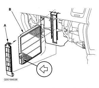

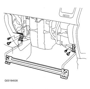

I have located the interior air filter behind the glove box in my Honda Pilot. I removed the glove box.
However, there is a double bar blocking the way of removing the air filter. I can remove the metal one, but the plastic one is connected to the dash covering. How do you get it out of the way?

[quote:a5e931ca9c="Allen Vik"]Interior problem
2003 Honda Pilot 6 cyl All Wheel Drive Automatic 36000 miles
However, there is a double bar blocking the way of removing the air filter. I can remove the metal one, but the plastic one is connected to the dash covering. How do you get it out of the way?[/quote:a5e931ca9c]you have to cut the plastic piece and throw it away when you are done.
