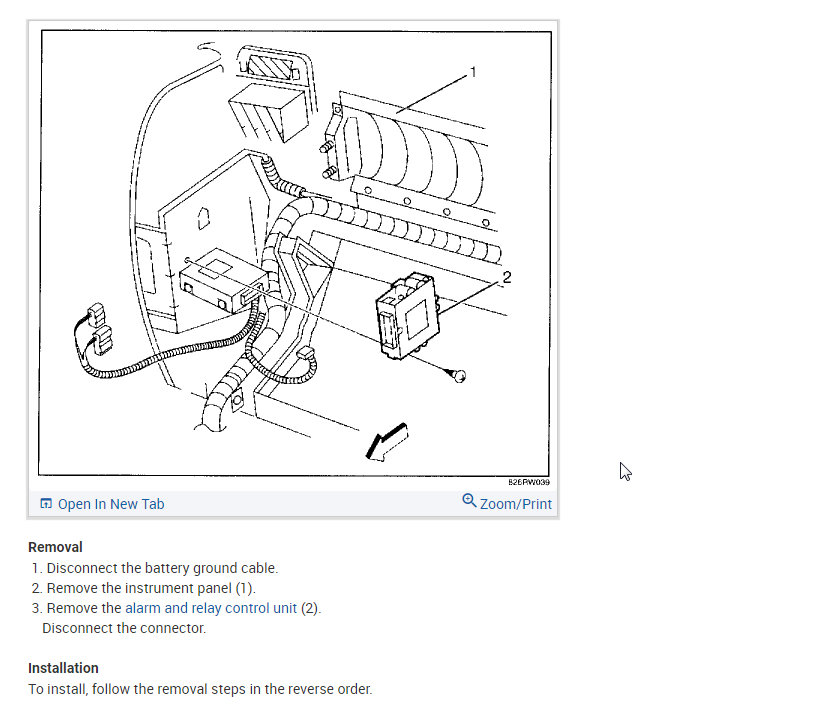

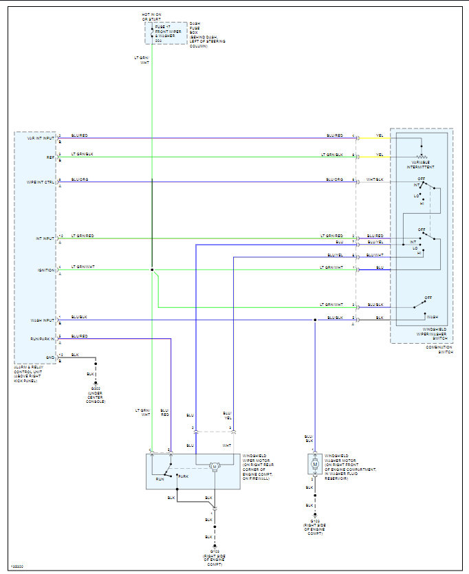

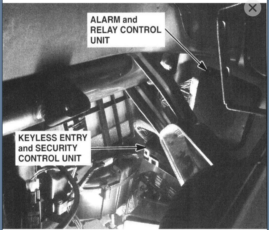

I see you put up a Blog about my model vehicle's wipers not parking and where the relay is located. I have a question, is there an easy way to repair this or can I just jump that relay out and replace it with another relay to get my wipers to park? I live in Virginia and I cannot get the vehicle inspected because the wipers will not park.
Jan 26, 2018 at 2:05 AM
You are correct that this is most likely a relay issue but the relay is park of a control module that would require replacement.
I attached the process below on how to replace this. Unfortunately there is not a relay that you are able to remove and replace. Let us know if you have other questions. Thanks
