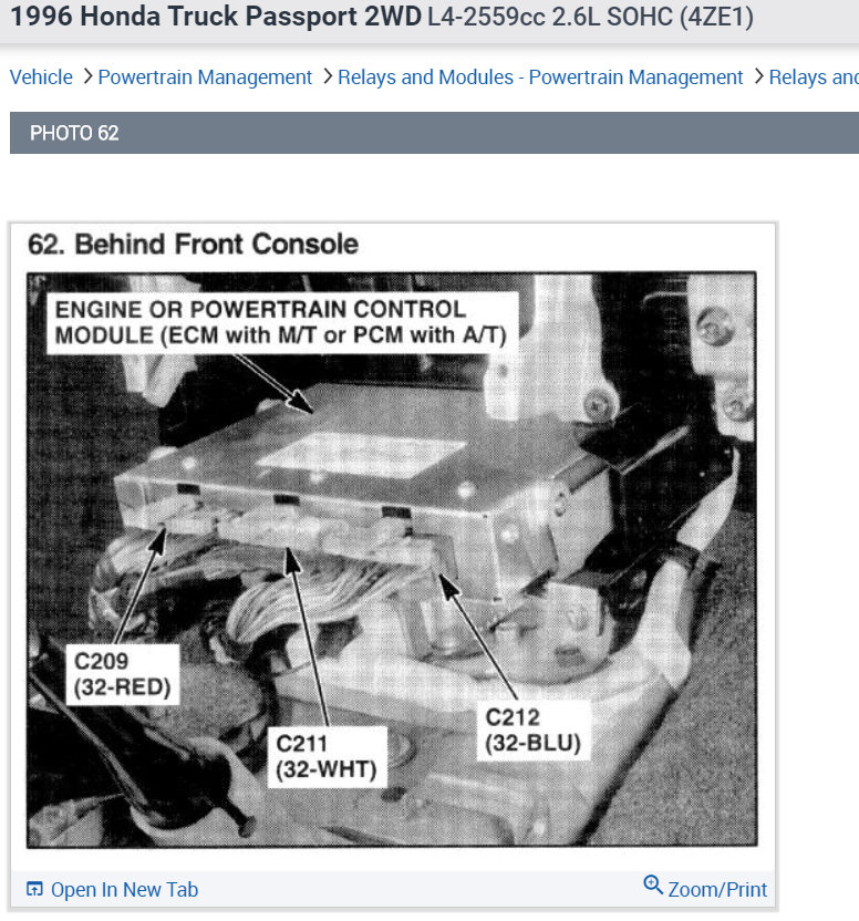

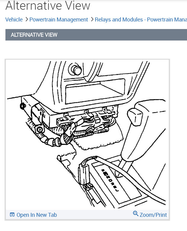

Just wandering if you know where the ECU is located? Thank you in advance

the ecu is located behind the plastic cover at the bottom of the dash over the center console just inside. Check out the diagrams (Below). Please let us know if you need anything else to get the problem fixed.
