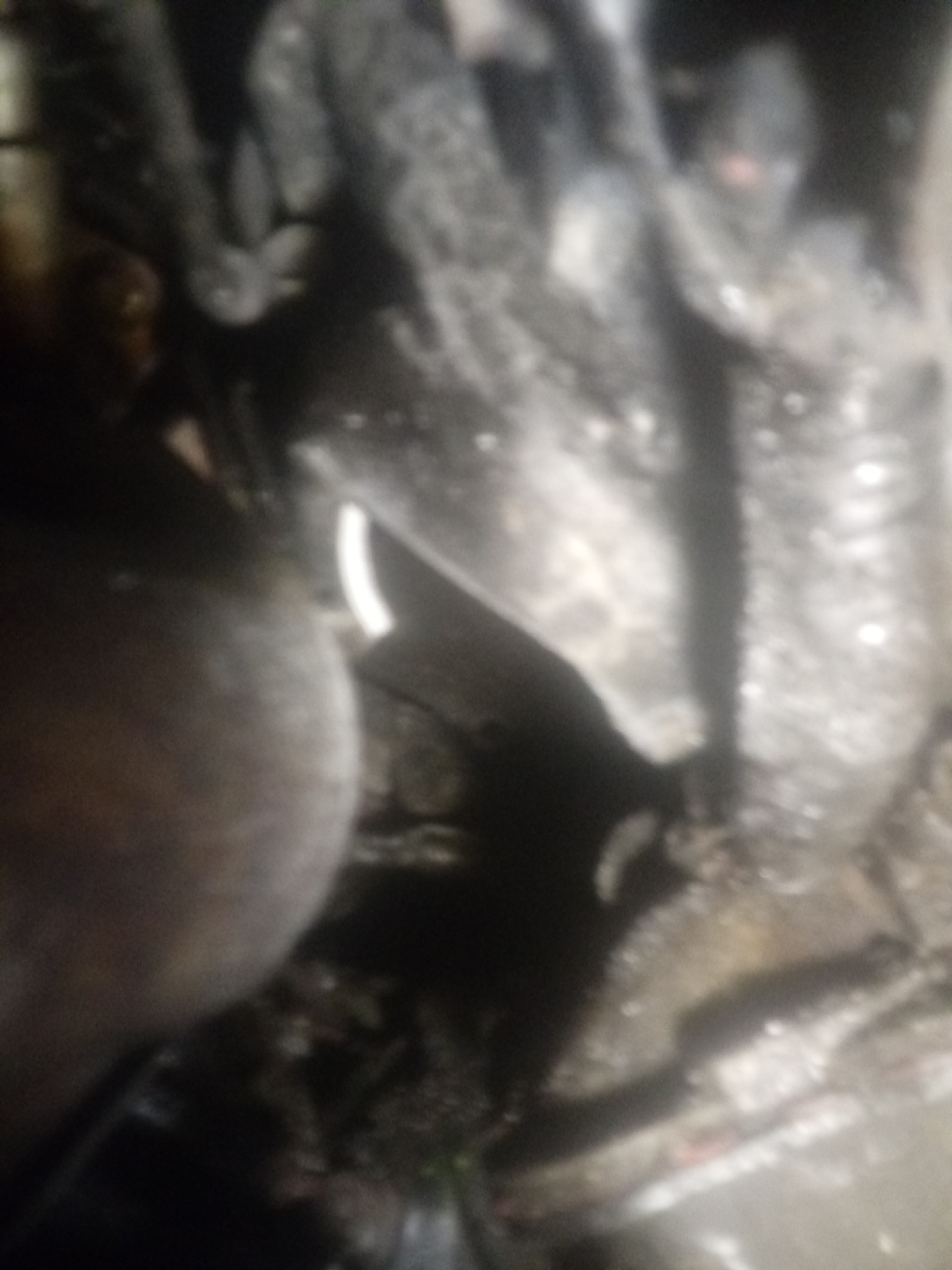

want to know what i have to take off to get starter out or if there is enough clearance to pull it out towards the back trans way also mitchell online, one yr is 30, can you change vehicles or is it 30 per vehicle to use there service.

Hi lag4brke,
Removal & Installation
1. Disconnect battery ground cable. Lift and support vehicle above ground. Disconnect 2 heated oxygen sensor connectors from left front exhaust pipe.
2. Remove left front exhaust pipe with catalytic converter to access starter. Remove starter heat shield and connectors. Remove starter bolts and drop starter toward bottom of engine.
3. To install, reverse removal procedure. Tighten starter and exhaust bolts to specifications.

Well you can spen time trying to break lose the manafold to exhaust pipe bolts qty (3x 17 mm socket size) and take a chance at breaking the manafold on your 200k+ mile passport may work. Some people have had success removing the moter to frame mount ( hard to get to 14mm head bolts will take a wobble socket and a couple of long extensions from under the hood... What we do at the ranch were we buy these vehicals cheap and use them until they are worn out unbolt the starter and twist it around the cavity that its in an un bolt/clip and push it out of the way and take a sawzall and cut the shroud and thermal braket off of the transmission housing this will still allow you to reninstal the thermal sheilding with only one bolt instead of two. Cutting the transmission housing will allow you to change starters freely with out removing anything else
