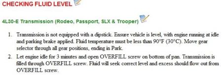

how do u check the transmission fluid

https://images.2carpros.com/forum/automotive_pictures/261618_Noname_1984.jpg
