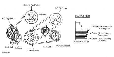

1997 Honda Passport 6 cyl Four Wheel Drive Automatic
how do I change the fan belt on this vehicle?
is there a belt tensioner? i can't see it...
how do you take out the first belt?
