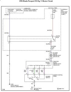

Here is a wiring schematic of the heater blower. The easiest way is to apply voltage to the blower motor Blue/White wire through a fused source. With voltage applied to the 20 A fuse, are you getting voltage at the Blue/White wire? If yes, th most likely problem would be a fault with the relay circuit. It gets is coil power source from the voltage regulator. You can try disconnecting the power source from the alternatos and rewire it to the ignition switch or ACC wire circuit.

Sorry I was not more specific. I applied 12v to the 20 amp fuse and had no power at the blue/white wire at the blower motor. Is the blue/white wire the power source going to the alternator? So just take the wire and run it to the ignition switch or ACC circuit?

The Blue/White wire is connected to the fuse. I believe this wire is broken in between. Alternator wire is for activating the relay which is not the problem, it seems.
You can use it to connect to ACC with a fuse in between.
