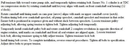

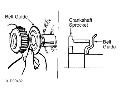

HOW DO I GET THIS BACK IN TIME? WE CHANGED THE WATER PUMP AND WHEN WE WERE PUTTING IT BACK THE TIMEING JUMPED OUT AND THE CAR WON'T START.

https://images.2carpros.com/forum/automotive_pictures/261618_Noname_1956.jpg
https://images.2carpros.com/forum/automotive_pictures/261618_Graphic_430.jpg
