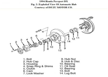

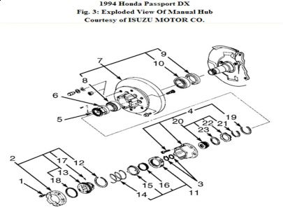

I need to know what the smaller of two seals is called. it is located by the hub seal, the hub seal is the larger of the two. can you help me?
Aug 6, 2009 at 8:40 AM
IMPALASS
  • 3,112 POSTS
Hello - To better assist you is your model just the DX, EX or LX? Also what is your engine size in liter? I have attached the manual and automatic of a DX model..........
