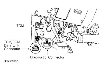

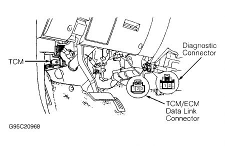

When trans get hot the transmission light comes on and i have to shift manually. I can shut off the engine and restart it and it is fine for a while. Can anyone tell me how to fix it?
6 cyl Four Wheel Drive Automatic

Hi rockyz1961, You need to get the DTC to find out what us wrong with the TCM or its sensors.
https://images.2carpros.com/forum/automotive_pictures/192750_PassportTCMDignostic01_1.jpg
https://images.2carpros.com/forum/automotive_pictures/192750_PassportTCMDignostic02_1.jpg
See which applies to your vehicle. Bridge the diagnostic connector and turn on the ignition switch. Count the flashing of the Check TCM light and post here.
