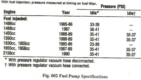

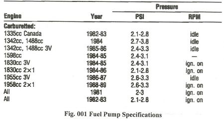

I'm inclined to say "no". The intake valves are the same, but the exhaust are different. The Camshaft is different also. Does that mean it won't work? Don't know, inclined to think not.
https://images.2carpros.com/forum/automotive_pictures/30961_pist_1.jpg
https://images.2carpros.com/forum/automotive_pictures/30961_pist1_1.jpg

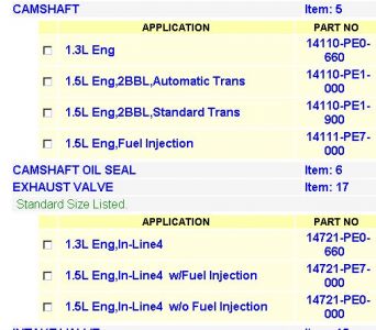

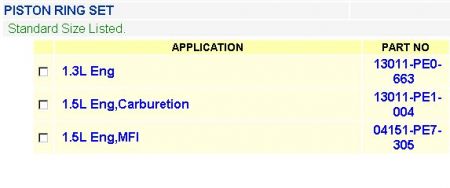

I thought you might find this of interest:
https://images.2carpros.com/forum/automotive_pictures/30961_scan1_1.jpg
https://images.2carpros.com/forum/automotive_pictures/30961_scan2_1.jpg
