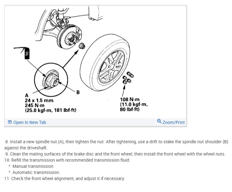

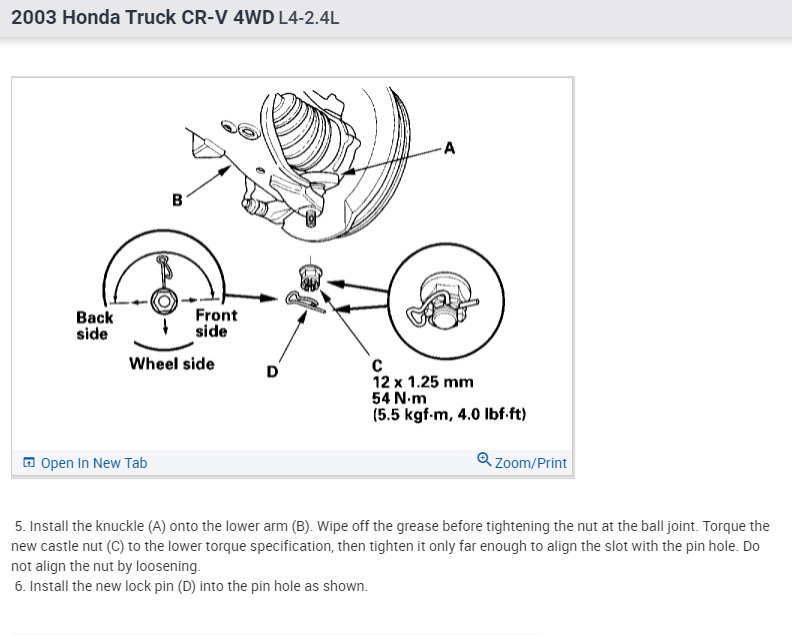

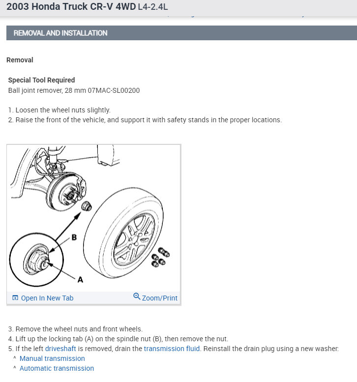

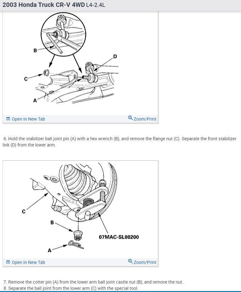

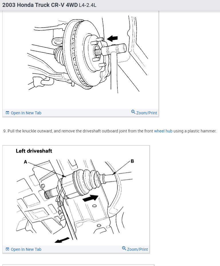

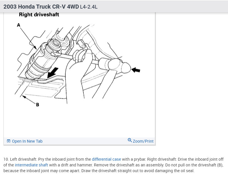

It sounds like the issue is with the CV axle.
When the CV axle gets worn or if it has a blown boot, it will allow dirt and debris in the joint and will make noise when you turn.
The CV axle can be replaced with using simple hand tools. You will have to raise the vehicle and secure it on jack stands to get started.
Here are couple of helpful articles:
https://www.2carpros.com/articles/how-a-cv-joint-works
https://www.2carpros.com/articles/replace-cv-axle
