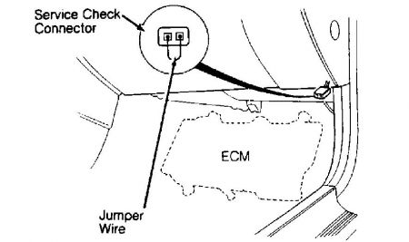

Hi jimmy.worley, It could be a sensor or the Transmission Control Module is bad. Try to see if you can retrieve any trouble codes.
https://images.2carpros.com/forum/automotive_pictures/192750_SCS91Accord_17.jpg
Use a paper clip to bridge the SCS and turn ignition on. If the D4 light starts to blink, count the blinks, delayed flashes = 10 and fast ones = 1. The codes would repeat in cycles till the ignition is turned off or paper clip is removed.
