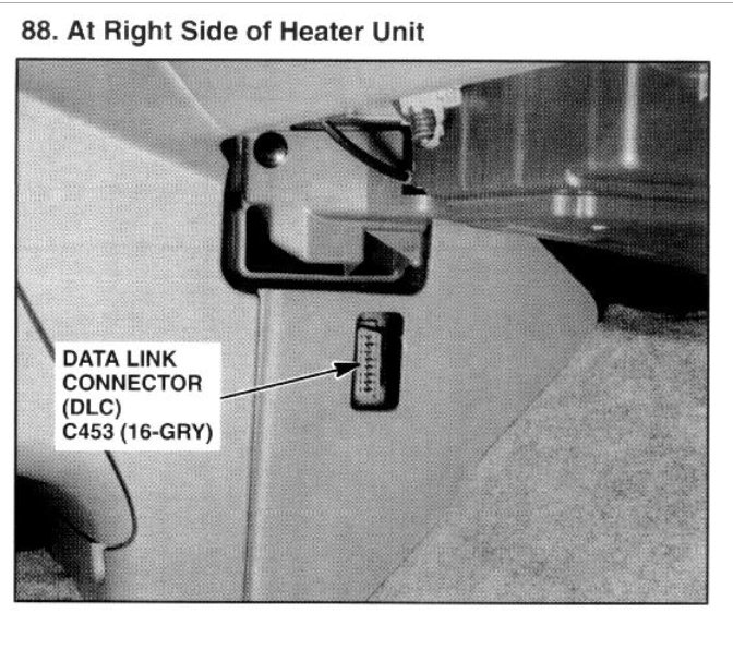

Where is the location of obd2 connector ( 16pin ) in honda odyssey 1998 ?
i'm looking so hard to locate it but i could not find it. I love this site please help me I need it so bad.

Hi there, The location o0f the ALDL data link connector is on the passenger's side center console.
https://images.2carpros.com/forum/automotive_pictures/61395_Graphic_168.jpg
Here is a larger image (below) Mark (mhpautos)

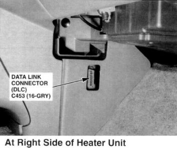

hi mr.mhpautos thank you for replay in my car i can't see obd2 connector in this locate My car was purchased from Saudi Arabia any ideas?
Nov 27, 2020 at 5:10 PM (Merged)
MHPAUTOS
  • 31,937 POSTS
Check the side kick panel's (both sides as well)
https://images.2carpros.com/forum/automotive_pictures/61395_58880584_1.jpg
mark (mhpautos)

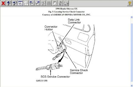

ALKAID
hi mhpautos yes my car is left hand drive i also se both side but i can't see the obd2 connector and about this picture :
https://www.2carpros.com/forum/automotive_pictures/61395_Graphic_168.jpg
I see service check connector port in this location.
Thank you for helping me

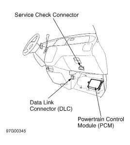

DALE28677
i need to find out where the diagnostic plug is so they can check to see what wrong check engine light comes on they can't find the plug
KHLOW2008
  • 41,814 POSTS
Hi dale28677, Check out the diagrams (Below). Please let us know if you need anything else to get the problem fixed.
https://images.2carpros.com/forum/automotive_pictures/192750_SCS96Odyssey_2.jpg
