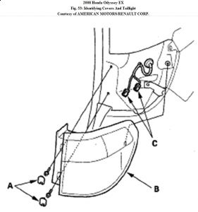

How do I changing rear indicator lens?
Aug 31, 2009 at 3:19 AM
KHLOW2008
  • 41,814 POSTS
Hi Capt Nemo, Our database only has info for up to 2008 model so I am providing a diagram of it and hope it is helpful. TAILLIGHT REPLACEMENT TAILLIGHT 1 . Remove the covers (A) and two bolts from the taillight (B). 2 . Carefully pull out the taillight, and disconnect the connectors (C) from the taillight. 3 . Install the taillight in the reverse order of removal.
