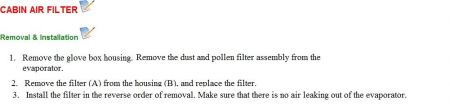

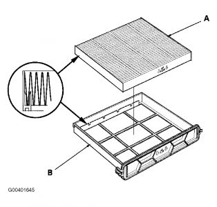

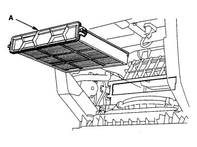

how to replace the cabin air filter on 08 odyssey?
Aug 9, 2010 at 8:15 AM
BLUELIGHTNIN6
Experienced Mechanic
16,542 POSTS
Aug 9, 2010 at 8:21 AM
