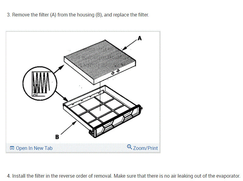

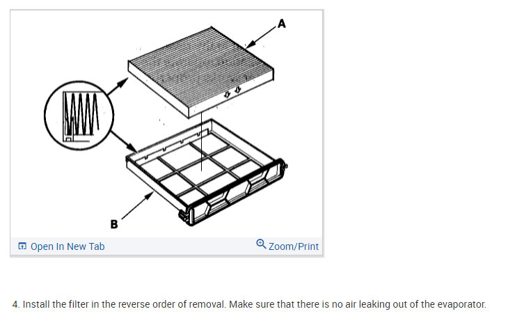

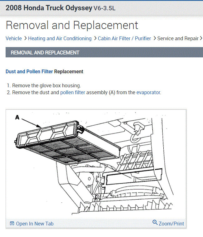

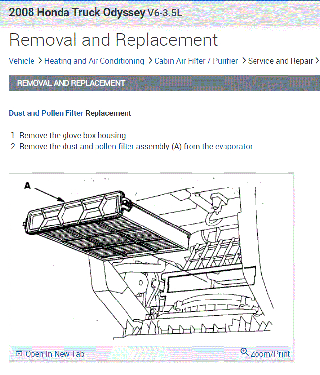

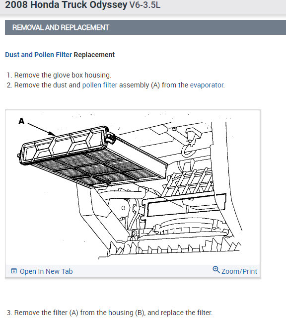

Where is the dust & pollen filter (they call it) I call it the cabin air filter. How do you change it? Didn't see anything out where you can get to it?
Sunday, July 18th, 2010 AT 8:29 AM
2 Replies
  • 109,885 POSTS
The cabin air filter on this vehicle is located behind the glove box. It is really easy to replace.
To get you started, here is a link that shows in general how one is replaced. You can use this as a guide when performing the replacement.
https://www.2carpros.com/articles/how-to-change-an-air-cabin-filter
If you look at the attached pictures, they are the directions specific to your vehicle for replacement.
