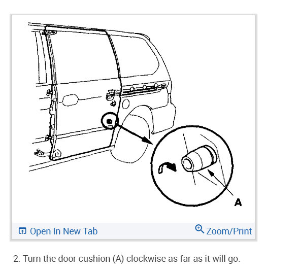

broken sliding door
2008 HONDA ODYSSEY
LESLOU
I accidentally backed out of my garage with the passenger side sliding door opened. It hit the garage and came off track. My husband got the door back on, but it won't close properly. It will close all the way, but you can tell that it is still not right. Is there a way to get it back on correctly, or was something inside the door bent or broken? Will it have to be repaired at a Honda dealership?
Aug 16, 2008 at 8:26 PM
KHLOW2008
  • 41,814 POSTS
Hi leslou,
Most probably something has been thrown off track/bent/out of alignment due to the accident.
To get it back to working order, some adjustment/parts replacement would be necessary and you can try your local body repair shop for adjustment first.

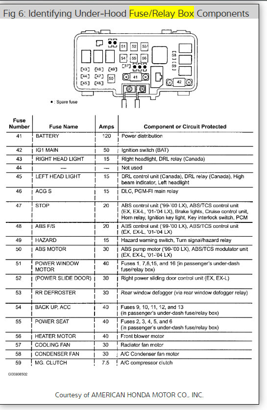

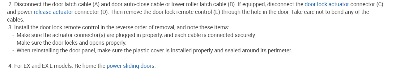

Door locks work but sliding passenger (electric) door will not open in either manual or electric mode. Door remains in fully closed position. Driver side sliding door works fine. Door seems to unlock okay. I have both sliding door panel and adjacent panel covering the motor for the cable assembly removed at this time. With door closed tight, I cannot seem to unbolt and free up the latch assembly itself. Is there a way I can manually trigger the latch assembly to release the door to open (with a screwdriver, lever, etc)?
Oct 28, 2019 at 10:39 AM (Merged)
  • 54,840 POSTS
Here are the manual releases for the sliding doors and the rehoming procedure as well:
Re-homing the Power Sliding Doors
1. Close the power sliding door.
2. Turn the power sliding door main switch OFF.
3. Slowly open the power sliding door manually.
4. Turn the power sliding door main switch ON.
5. Press and hold the power sliding door switch to close the door you just opened manually. Continue to hold the switch until the door is completely closed.
6. Do steps 1 thru 5 on the other power sliding door.

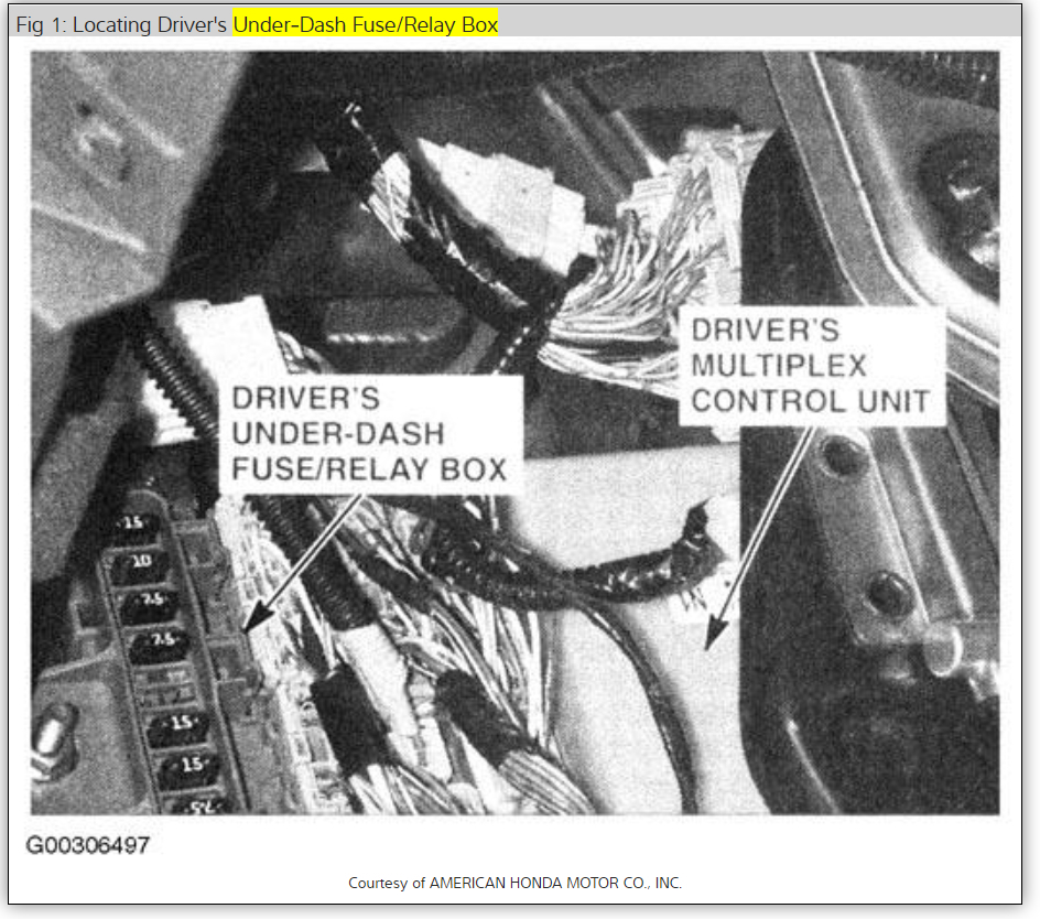

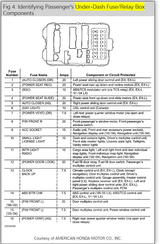

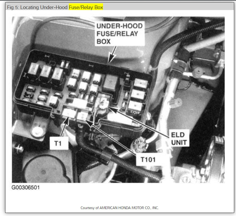

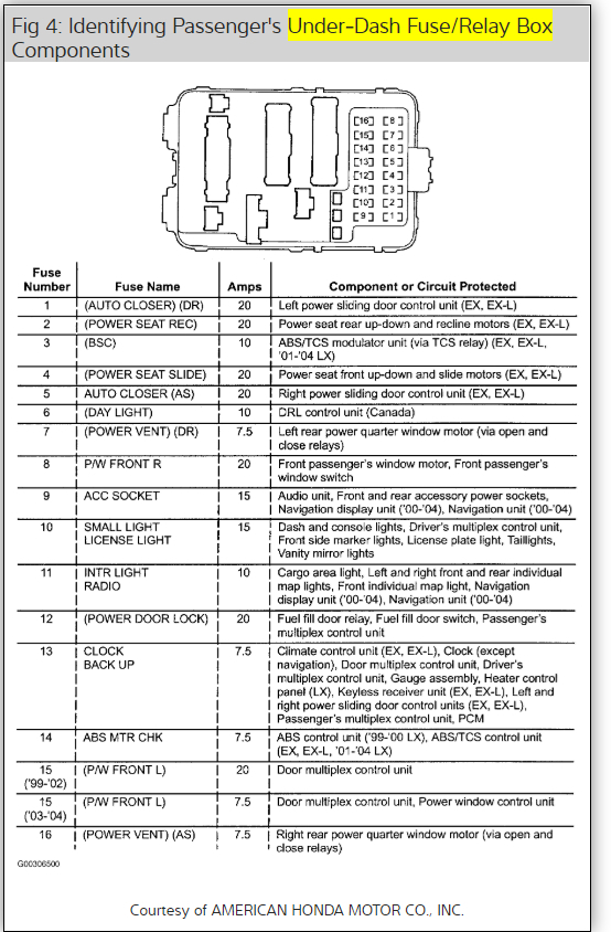

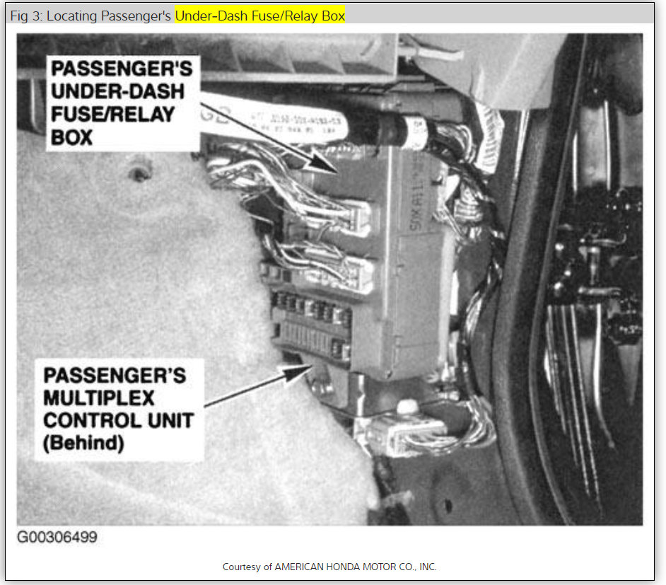

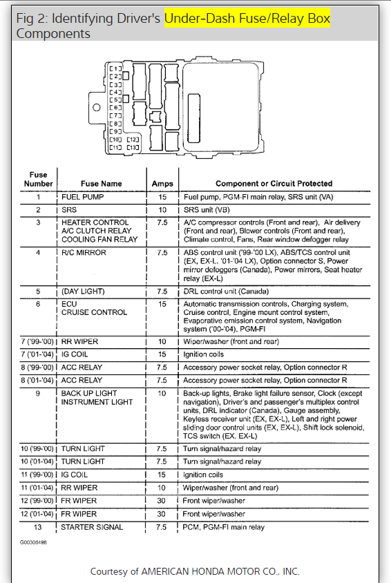

Have you looked at the fuses? here is a guide and the fuse panel location and identifications below:
Check out the diagrams (below). Please let us know what you find.

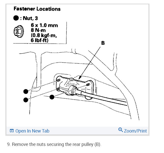

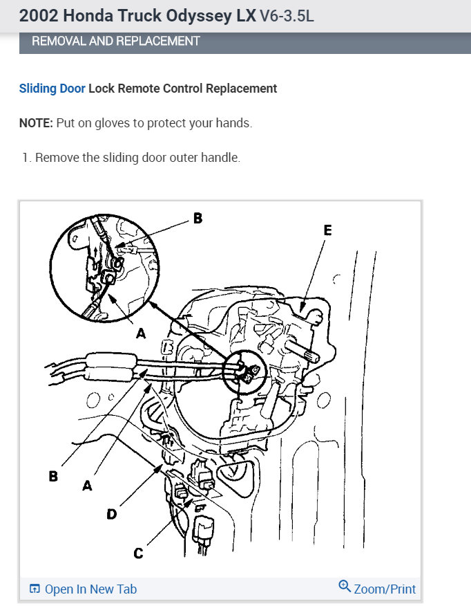

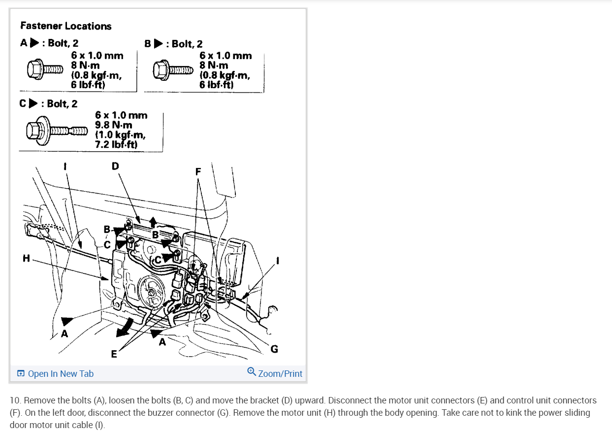

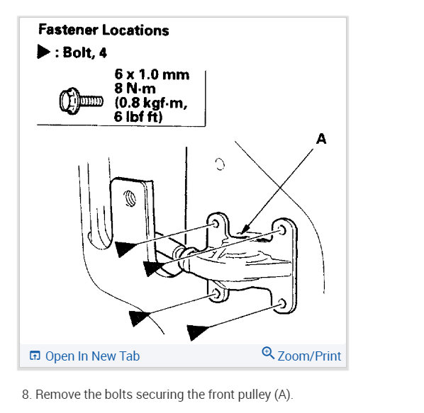

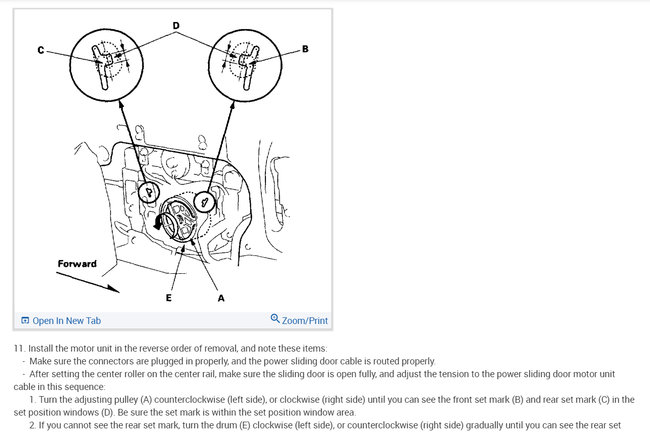

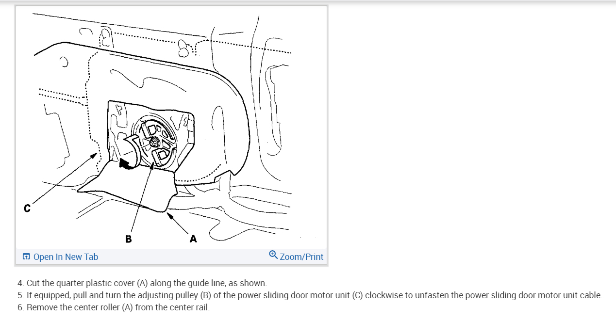

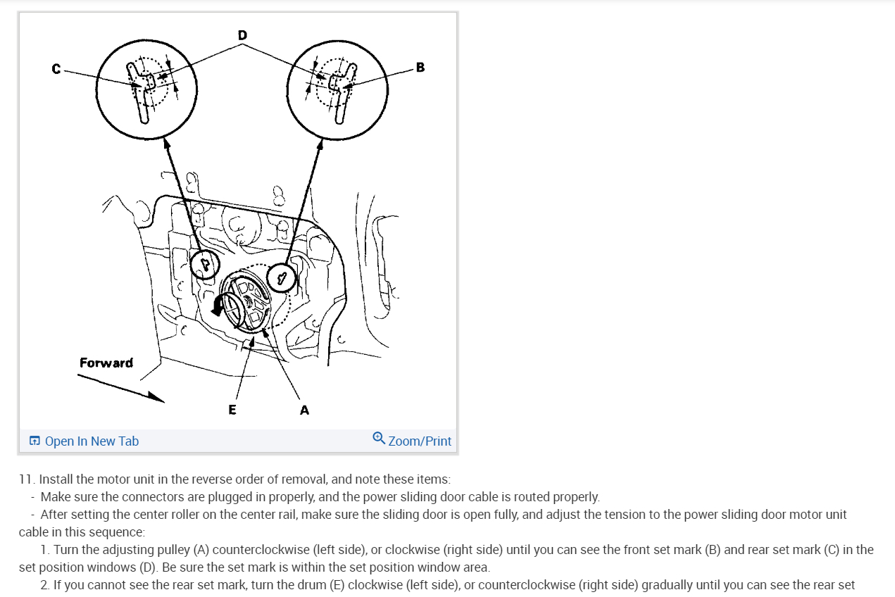

Me too! Here is the remainder of the repair diagrams for the door cable. Read through the instructions before you begin. Check out the diagrams (Below). Please let us know if you need anything else to get the problem fixed.

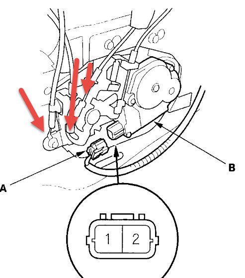

DBOUGE
The slider door on drivers side lock latch is stuck in lock position, making the door unable to close. What do I do?
Oct 28, 2019 at 10:40 AM (Merged)
HMAC300
  • 48,601 POSTS
try lubing it up then put a large screwdriver in it and see if it will latch on that if it does then work it back and forth a few times should be ok then.
DBOUGE
Got lock unlatch. Can now only manually close the slider due to no power. When I hand shut the slider when in off position, and pushing shut, the door engages to lock position, but nothing else happens, and nothing once flipped to on position. The other slider on passenger side has power working. Idk what to do cuz already did fuse checks and troubleshooting no luck, battery cables etc etc but no luck.
HMAC300
  • 48,601 POSTS
check to see if yo can hear lock functioning when you try to power it if youcan it may be a clip broken and rod or cable has broken. see pics also try a reset otherwise the car will need scanning by a pro to see if something like a sensor is bad.

MNAZAR
Electrical problem
2002 Honda Odyssey 6 cyl Front Wheel Drive Automatic 100 M miles
The Sliding doors stopped working after one of my sons forced the door to open, to retrieve his jacket. My hunch is that a fuse burnt up.
I see the fuse box located under the steering wheel, but I do not know what fuse I should be replacing, and since our car was bought used, we do not have a manual.
Can you help me out with telling me where I can find a picture of the fuse box - or could you indicate what fuse it is I need to change?
Thanks a lot!
EMJOHN
  • 6 POSTS
There are several fuses.
Primary under hood fuse box is located in the back or the engine compartment on the passenger's side. Check fuse # 11, 30A. ....... Secondary under hood fuse box is located next to the battery. Check fuse # 1, 30A. ....... Passenger's side interior fuse box is below the dash on the kick pannel. Check fuse # 1, 20A, and check fuse # 5, 20A.

2CARPRO JACK
  • 11,533 POSTS
The door will require a little electrical troubleshooting.First, check all fuses, interior and exterior (underhood power center)Remove the switch from the dash and use a test light to verify power in, then check that the switch is powering up both diresctions. Then if ok will have to remove panel to access the motor assembly, useing test light verify power is switching depending on the dash switch direction. If all is Ok then the motor is most likely bad. The emissions light is a dual light system in conjunction with the Check Engine Light. Might need a scanner to clear the light

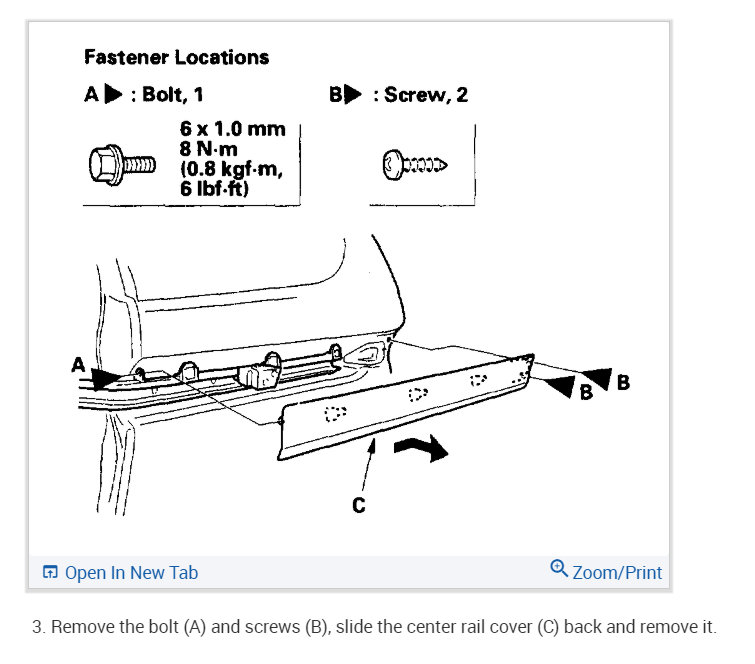

CNISCO

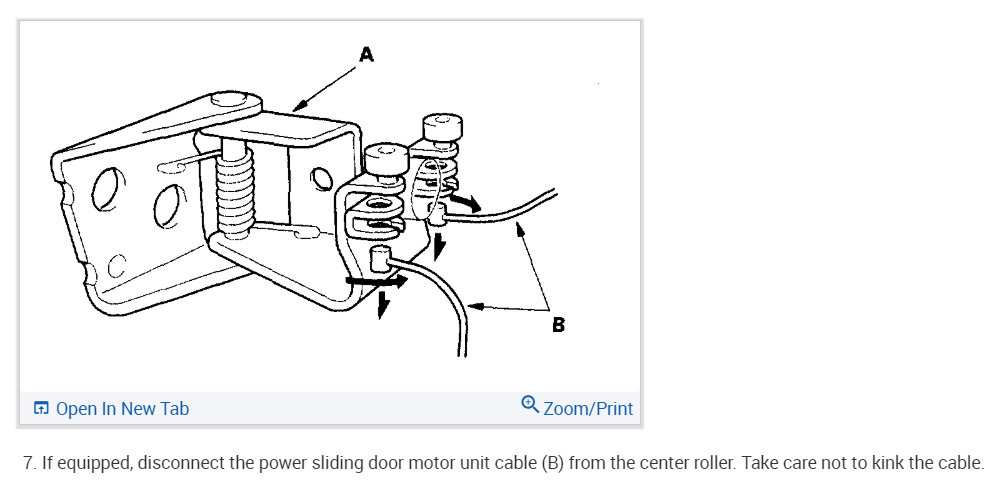

I need to replace the center roller on one of my power sliding doors. How do I disconnect the door cable from each side of the center roller? I don't know how to get some slack so I can slide them out of their grooves.

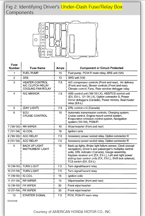

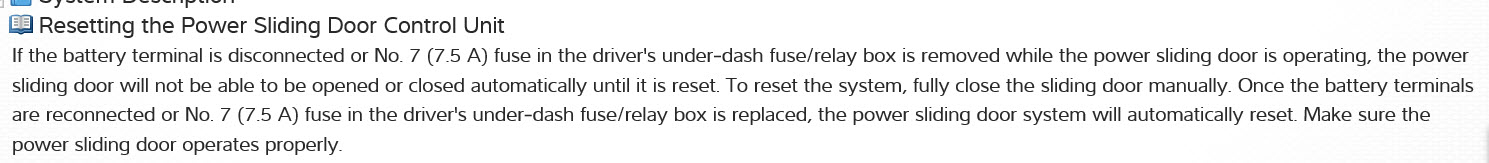

WLS18782
After instsalling a new battery, neither power sliding rear door will work electronically from any switch. With the main switch off, the doors can be operated.
Oct 28, 2019 at 10:41 AM (Merged)
KHLOW2008
  • 41,814 POSTS
Hi wls18782,
Try resetting the control unit and see if it works.
RESETTING THE POWER SLIDING DOOR CONTROL UNIT
If the battery terminal is disconnected or No. 7 (7.5 A) fuse in the driver's under-dash fuse/relay box is removed while the power sliding door is operating, the power sliding door will not be able
to be opened or closed automatically until it is reset. To reset the system, fully close the sliding door manually. Once the battery terminals are reconnected or No. 7 (7.5 A) fuse in the driver's under-dash fuse/relay box is replaced, the power sliding door system will automatically reset. Make sure the power sliding door operates properly.

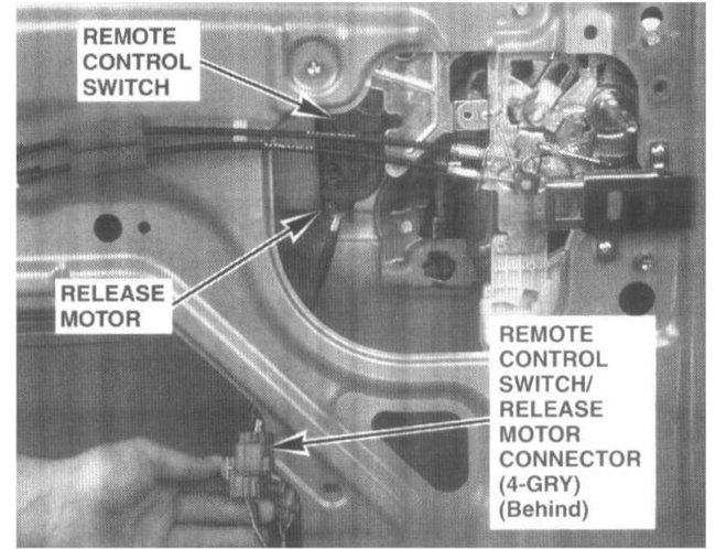

RTRIKE
The sliding door on the passenger side quit working. If you pull the outside handel you can here the relay click inside on the right rear. The door will not respond to the outside handel, the inside switch or the remote. Sounds like a control module or a fuse for the door might be the problem, don't know where to look.
KHLOW2008
  • 41,814 POSTS
Hi Rtrike,
First you should try reprogramming.
PROGRAMMING
RE-HOMING THE POWER SLIDING DOORS
Close the power sliding door. Turn the power sliding door main switch OFF. Slowly open the power sliding door manually. Turn the power sliding door main switch ON. Press and hold the power sliding door switch to close the door you just opened manually. Continue to hold the switch until the door is completely closed. Proceed with other door in same order.

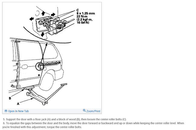

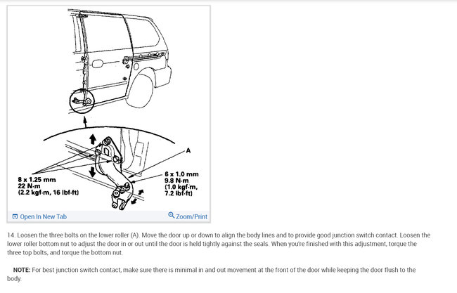

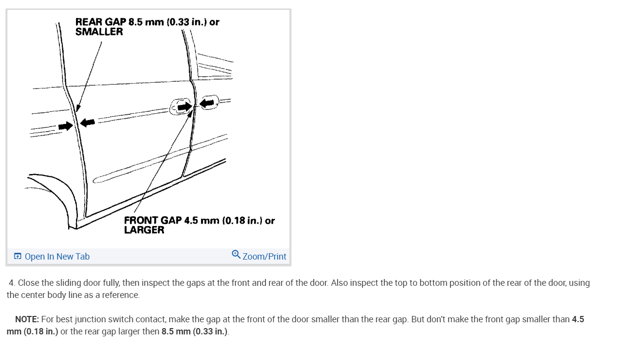

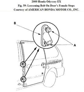

BILLYBRUCE1

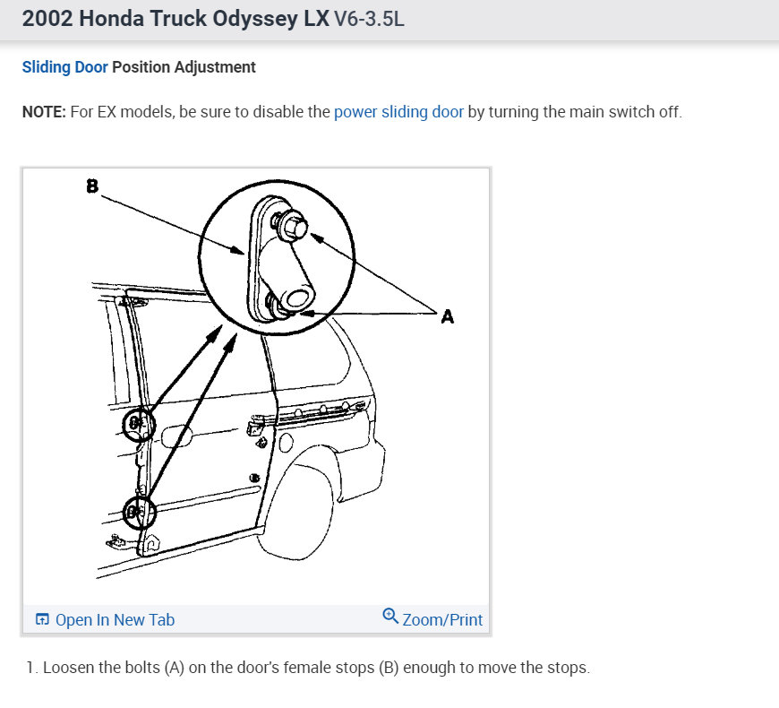

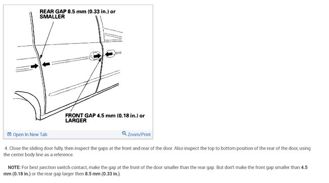

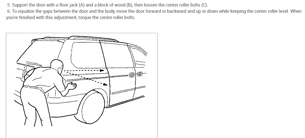

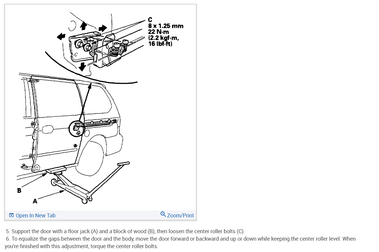

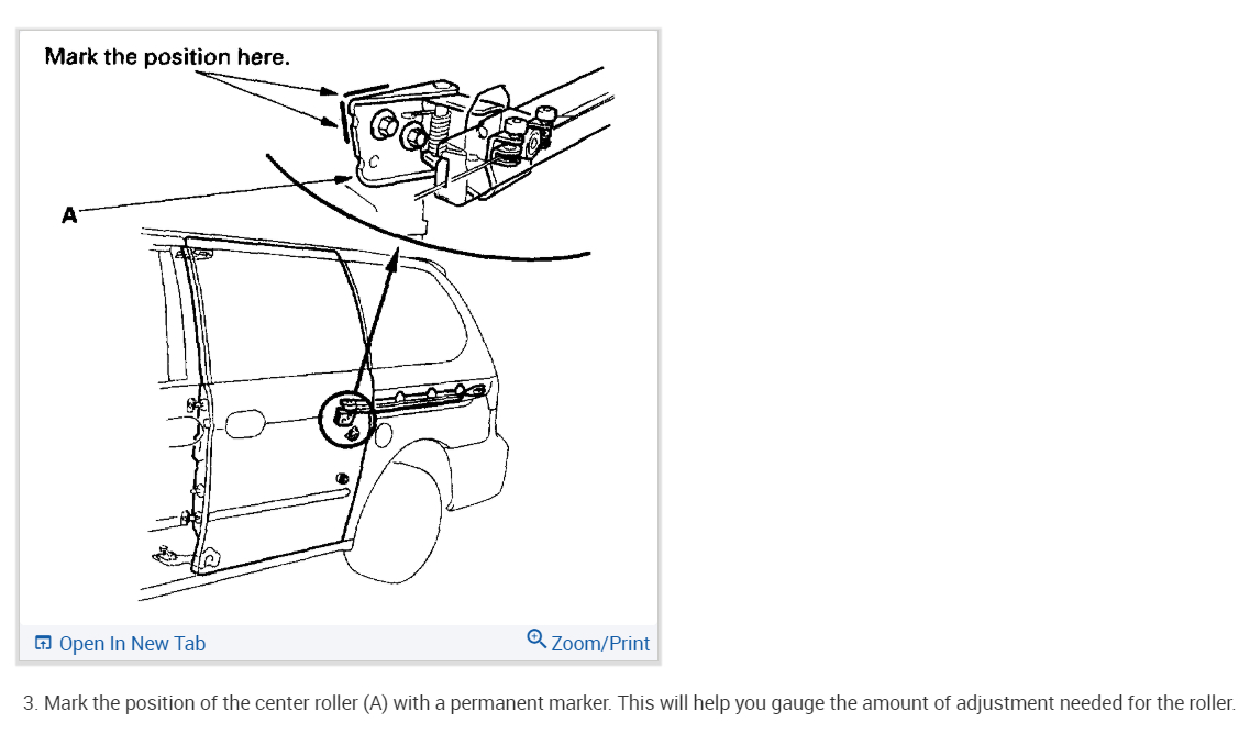

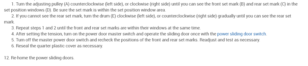

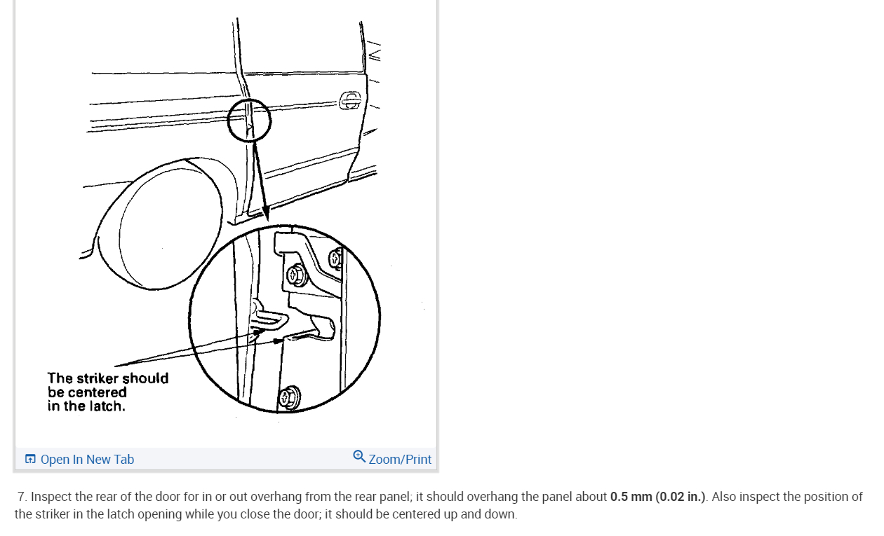

The manual sliding door sticks and seems to need an adjustment. Is there one?
KHLOW2008
  • 41,814 POSTS
Hi billybruce1, Yes, door adjustment can be made but the procedures are rather time consuming. Here is one part of 14 diagrams and adjusting procedures comes up to 20 steps.
https://images.2carpros.com/forum/automotive_pictures/192750_DoorSlideAdjust00Odyssey01_1.jpg
