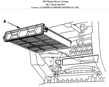

1 . Remove the glove box housing. See GLOVE BOX HOUSING. Remove the dust and pollen filter assembly from the evaporator. See Fig. 1.
https://www.2carpros.com/forum/automotive_pictures/192750_CabinFilter07OdysseyTouringFig01_1.jpg

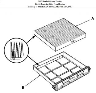

2 . Remove the filter (A) from the housing (B), and replace the filter. See Fig. 2.
https://www.2carpros.com/forum/automotive_pictures/192750_CabinFilter07OdysseyTouringFig02_1.jpg
3 . Install the filter in the reverse order of removal. Make sure that there is no air leaking out of the evaporator.

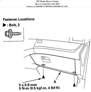

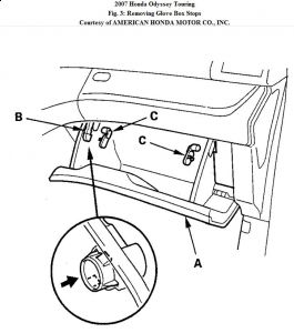

1 . While holding the lower glove box (A), release the damper (B) and remove the glove box stop (C) on each side. See Fig. 3.
https://www.2carpros.com/forum/automotive_pictures/192750_CabinFilter07OdysseyTouringFig03_1.jpg
2 . Remove the bolts, then remove the lower glove box (A). See Fig. 4. Install the lower glove box in the reverse order of removal.
https://www.2carpros.com/forum/automotive_pictures/192750_CabinFilter07OdysseyTouringFig04_1.jpg
