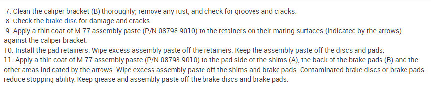

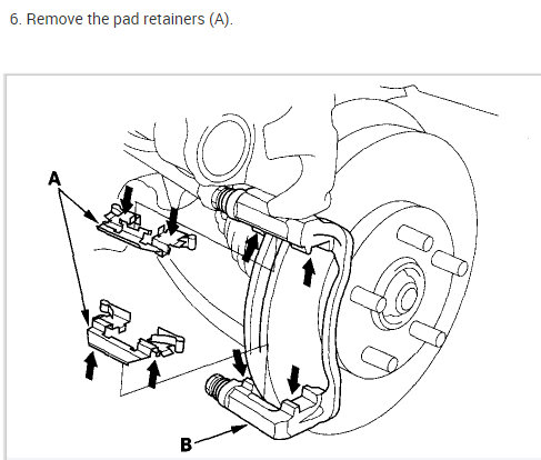

The brake sounds grinning does not turn off when you release the brake, I need front brakes.
Sunday, December 6th, 2009 AT 8:07 AM
DANNY L
  • 5,648 POSTS
Hello, I'm Danny.

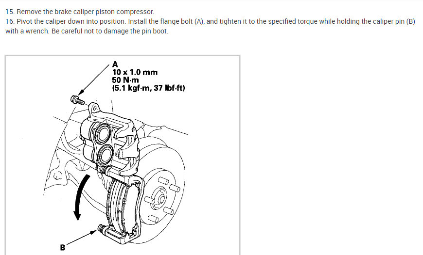

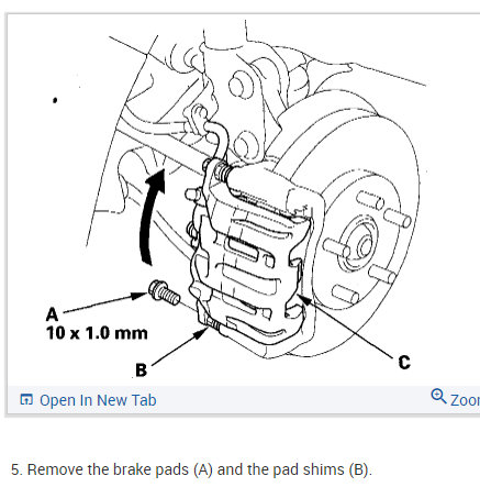

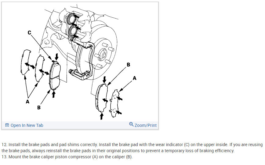

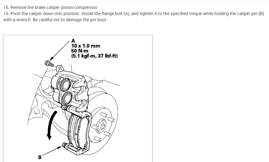

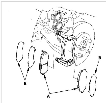

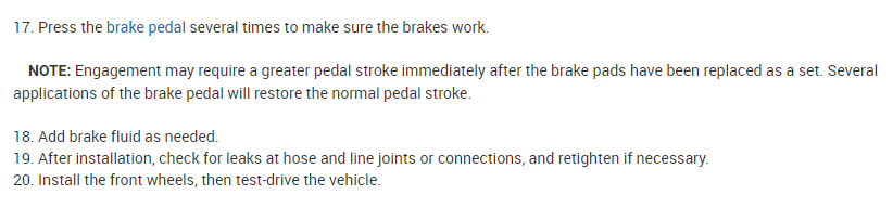

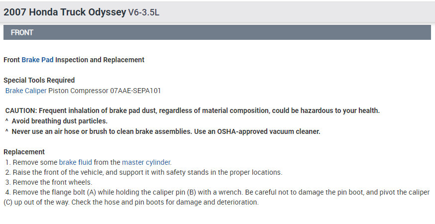

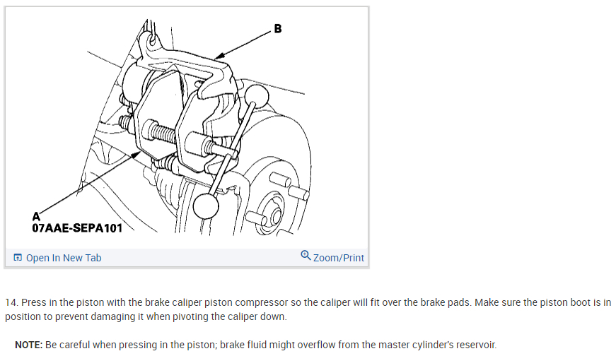

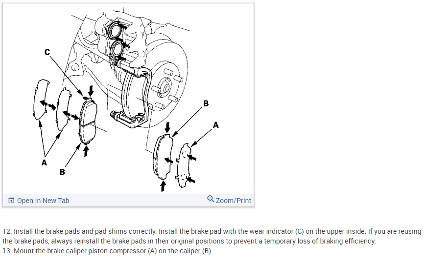

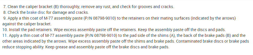

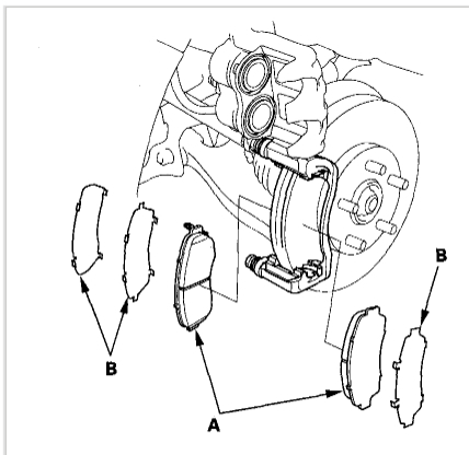

Here is the information you requested. The brakes might be sounding that due from having metal on metal contact from worn pads worn pads. This is a tutorial showing what is involved on how to change front brake pads and brake rotors.
I've attached picture steps below on how to change the front brake pads on your Honda. Hope this helps and thanks for using 2CarPros.
