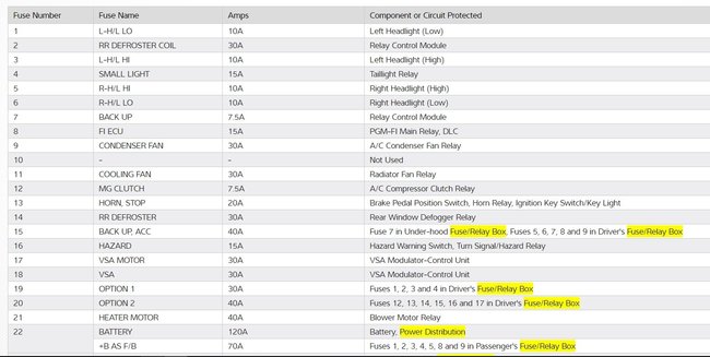

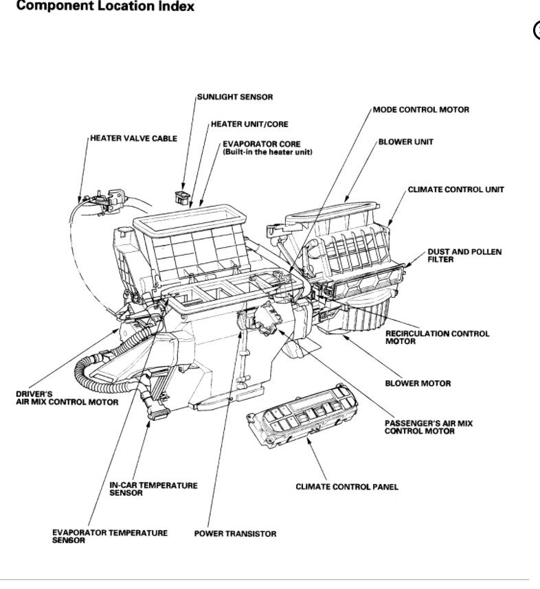

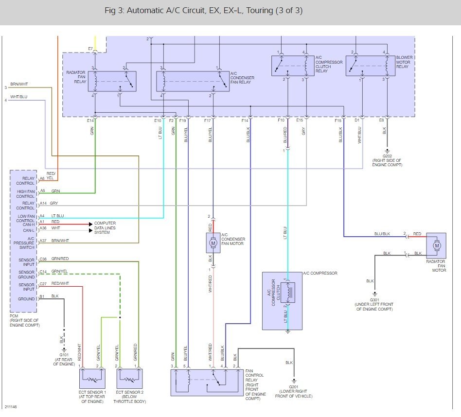

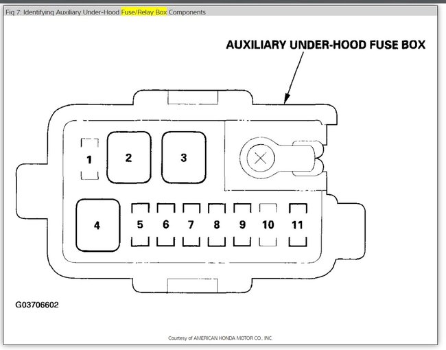

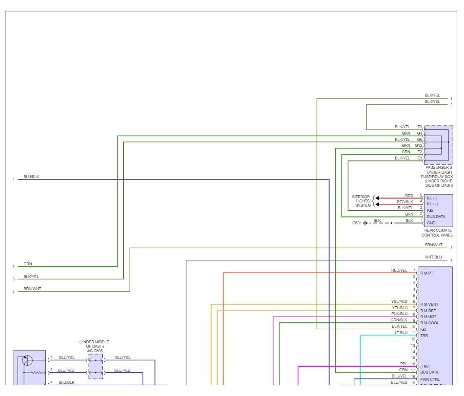

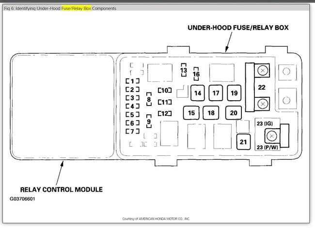

Air Conditioning problem 6 cyl Front Wheel Drive Automatic 85000 miles

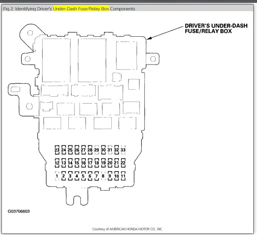

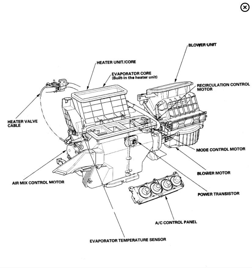

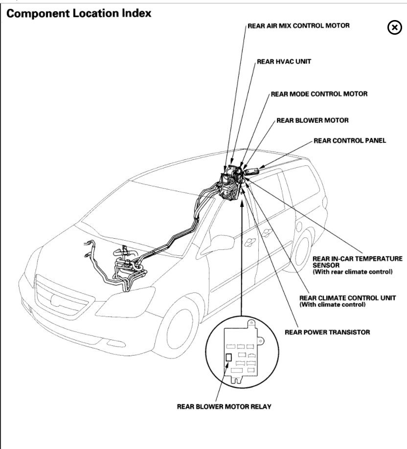

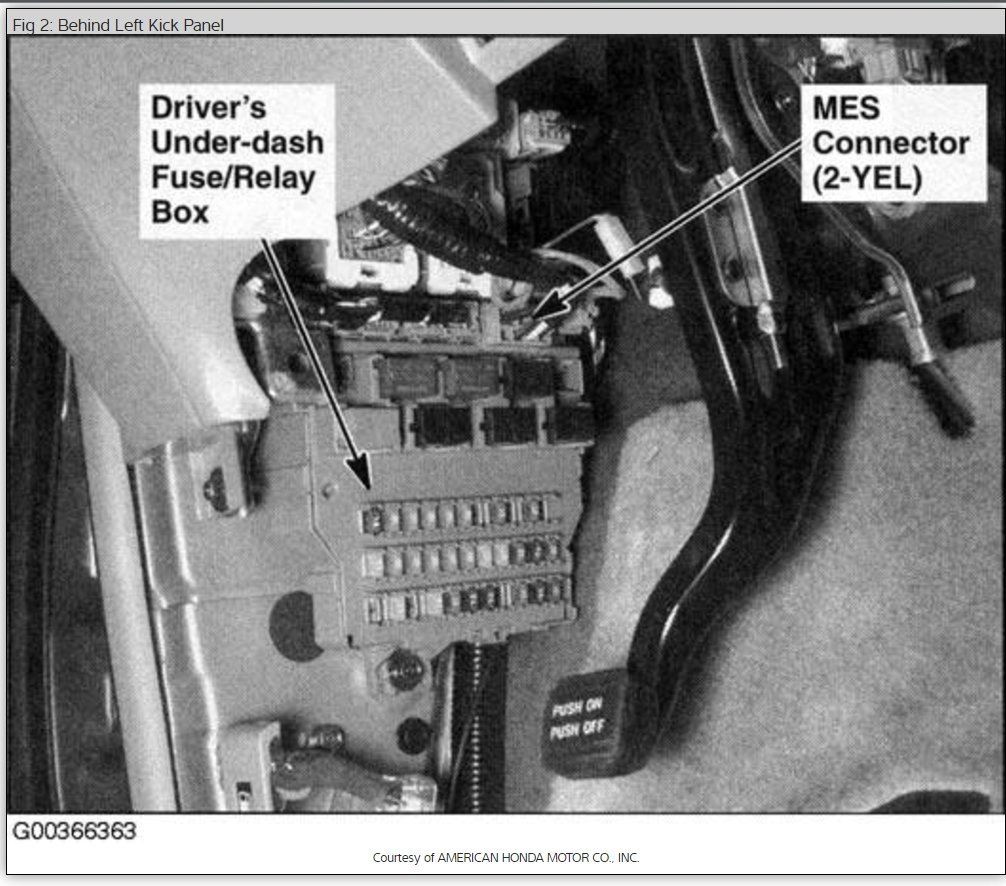

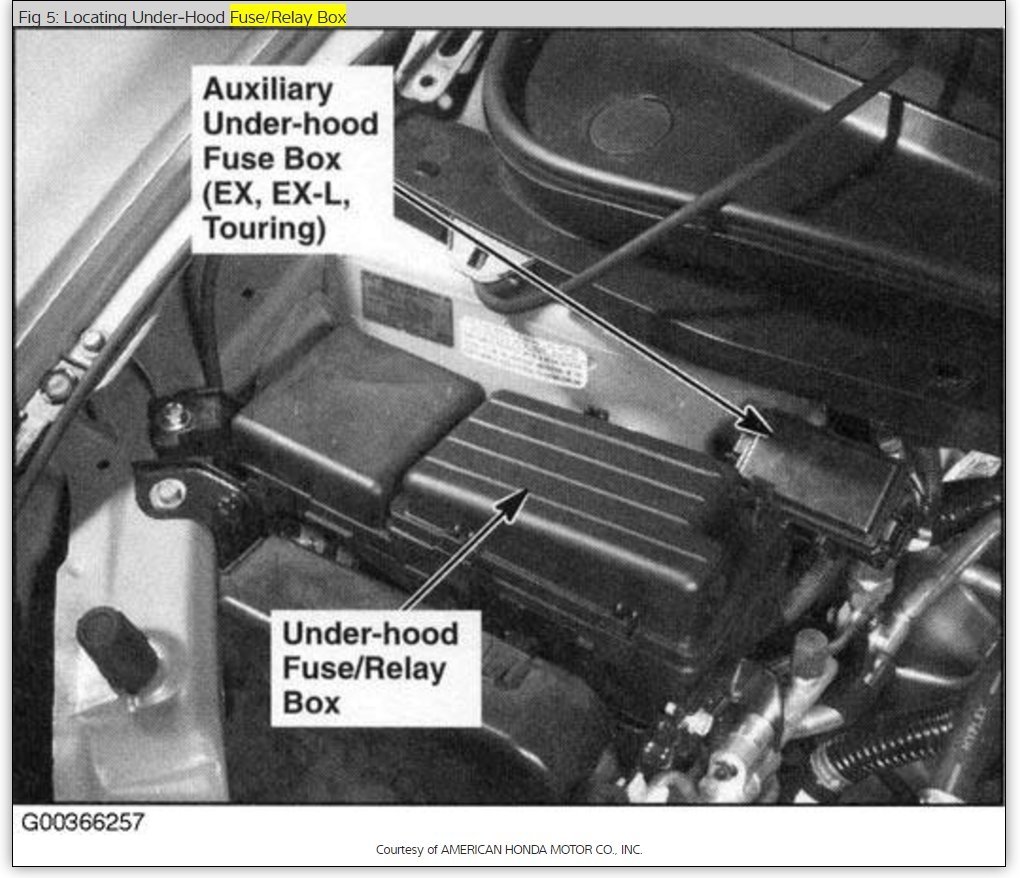

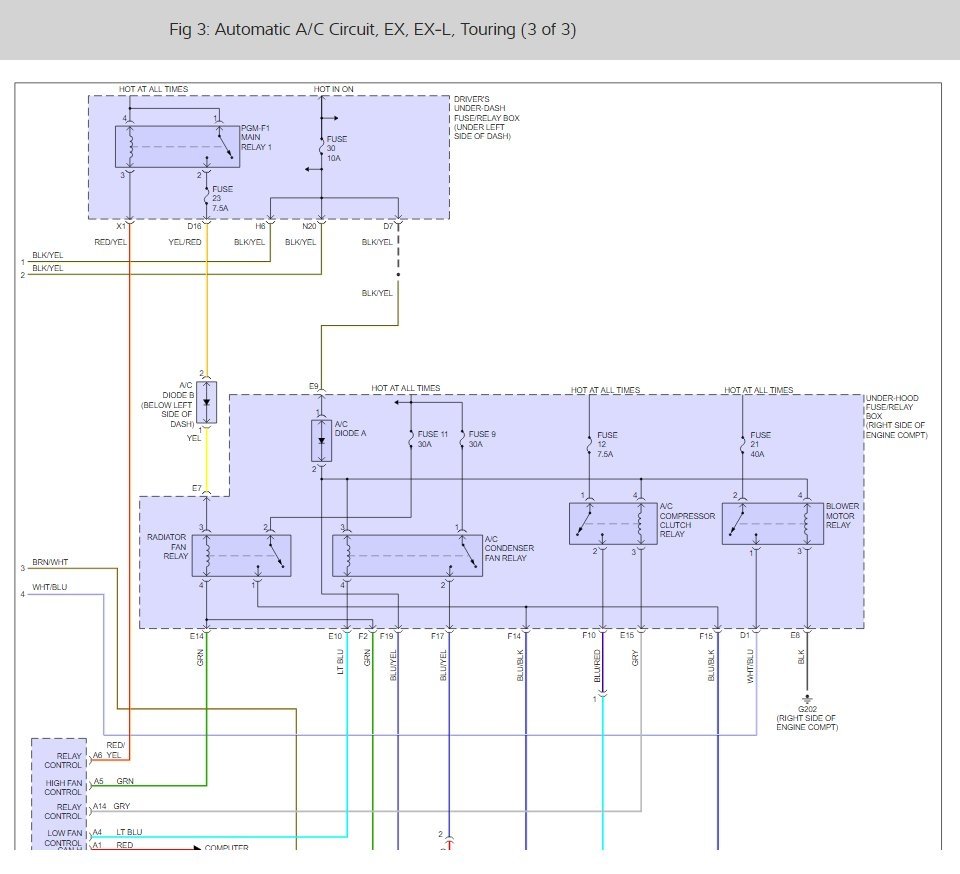

Rear a/c and heat work fine via front and rear controls. Front has no airflow (cold or hot) from vents. Is there a separate blower for front and rear or is it the same? Is there a fuse for each, etc? What can I look for.

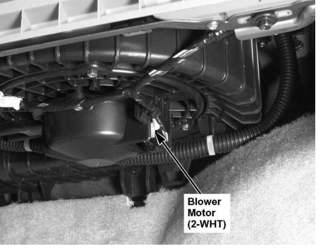

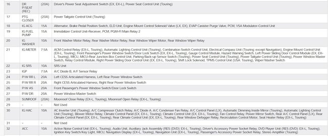

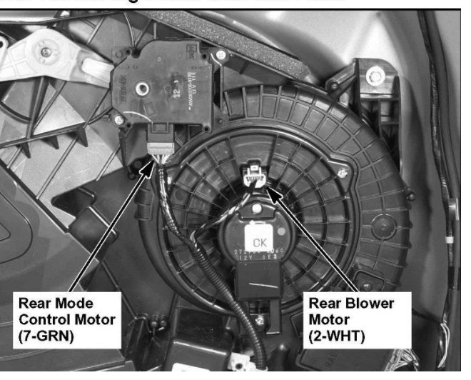

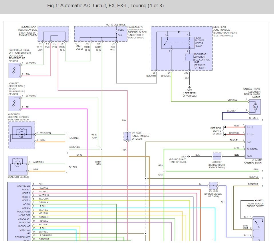

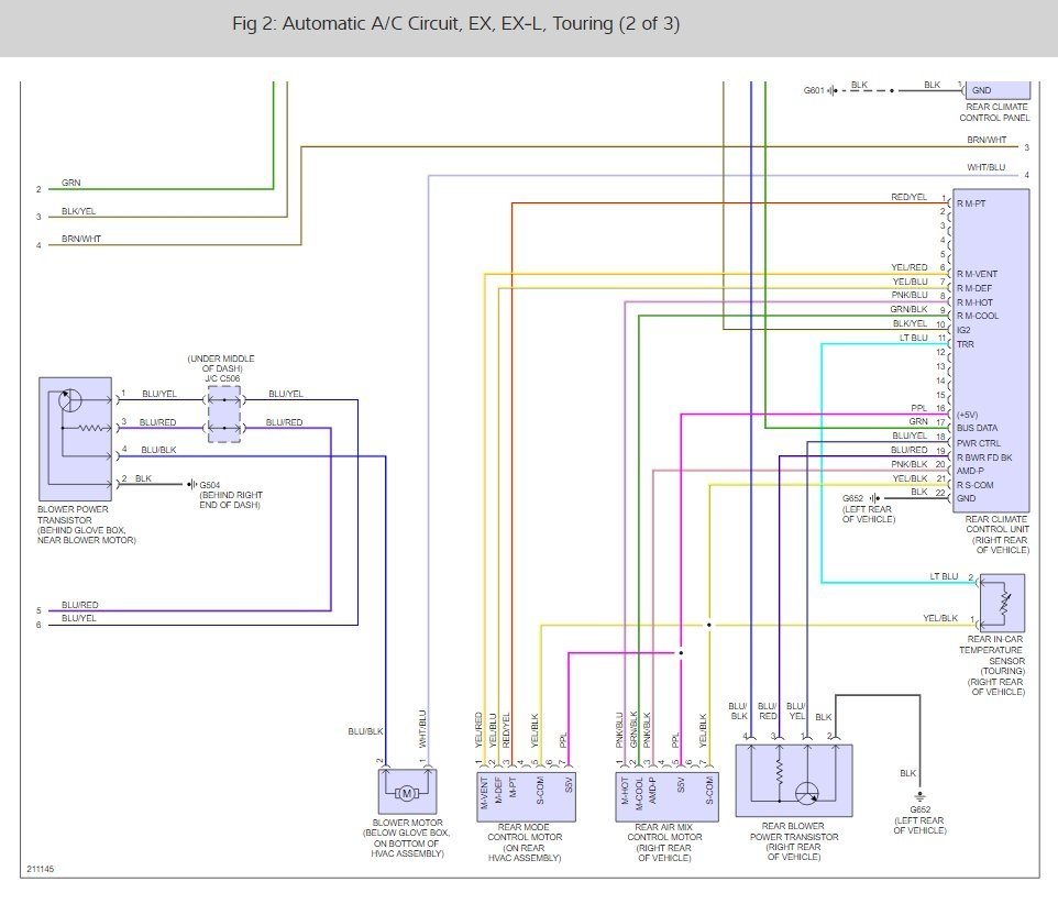

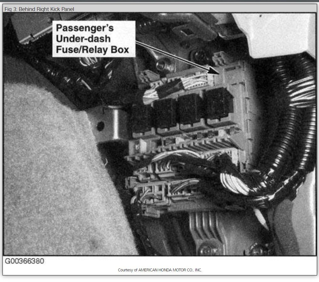

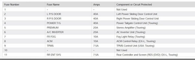

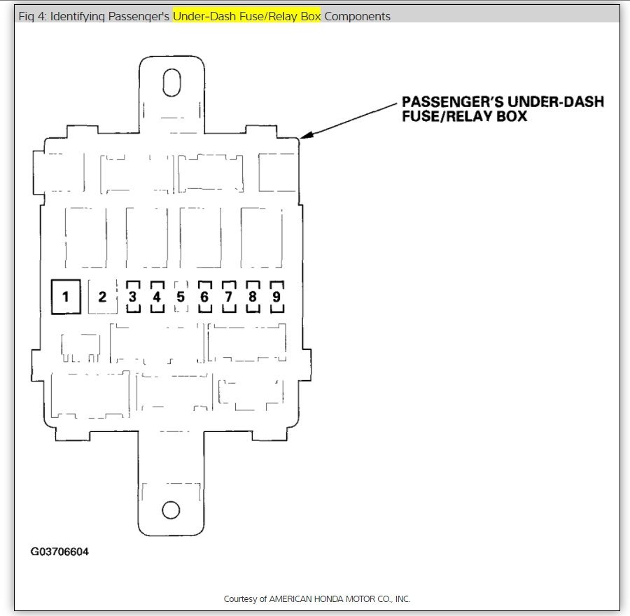

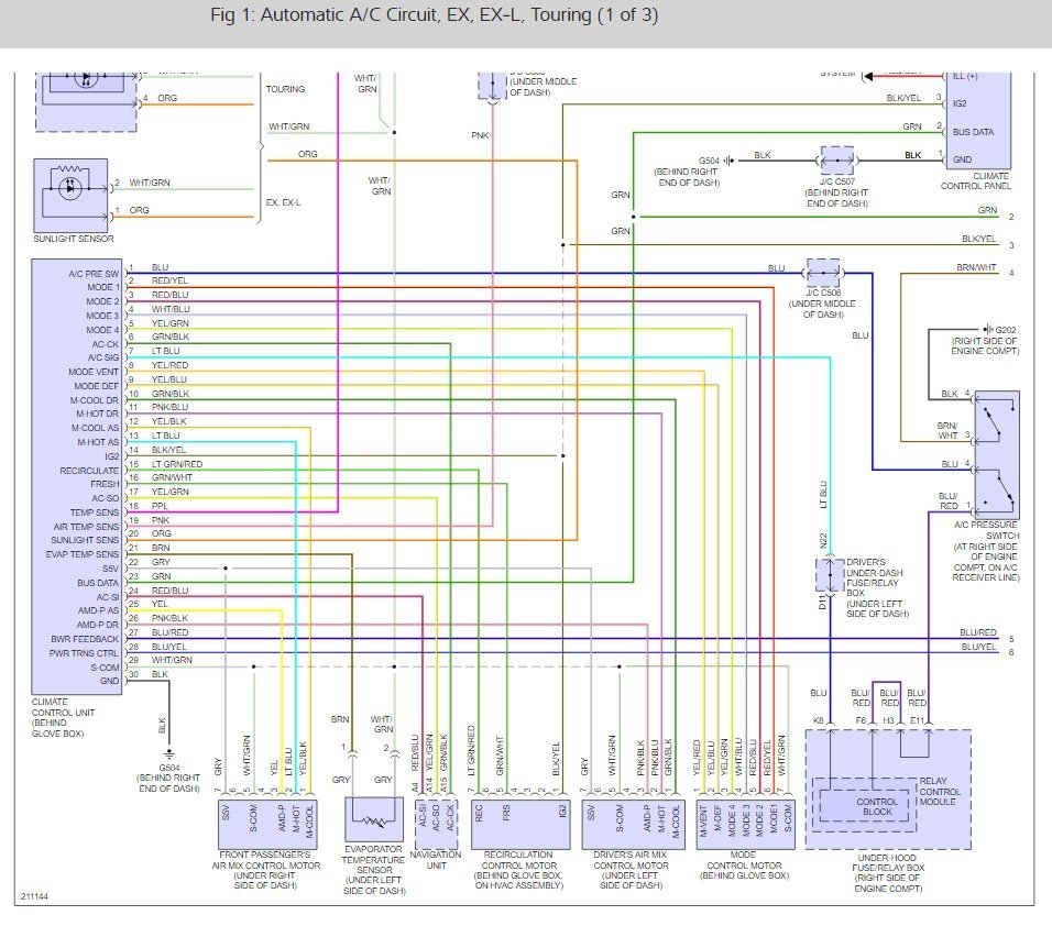

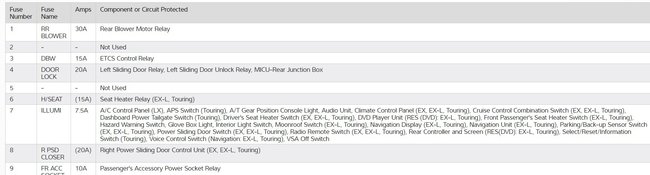

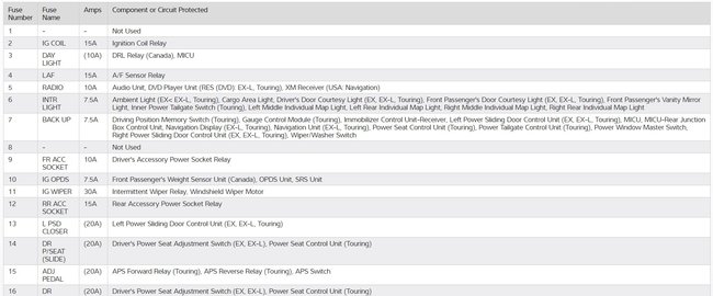

Yes there is a separate blower fan motor for the front the of the car, Here is a guide and some diagrams (below) that will help you get the problem fixed.
https://www.2carpros.com/articles/blower-fan-motor-works-on-high-speed-only
Here is a guide to help check the electrical, check the fuse and the relays as well/
and
and
Please run some tests and get back to us we are interested to see what it is.

My front heater fan stopped working, the rear works fine only the front. Is there a fuse for this fan that would cause this or is it something more serious.

Check fuses under hood fuse and relay box also check fuses under dash fuse and relay box
