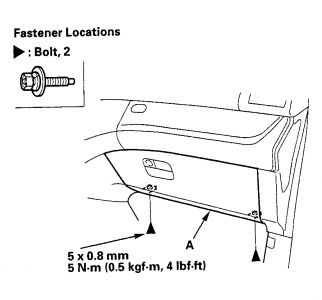

How do I change the cabin air filter? I understand it is behind the lower glove compartment. How do I access that area?

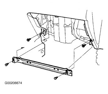

remove the glove box first , then the support bar and the filter is right behind it

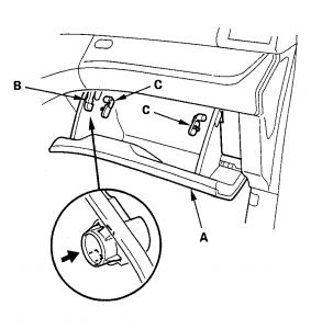

Exactly how do I remove or lower the glove compartment on a 2006 Honda Odyssey (EX-L) to replace the cabin air filter?

Box removal
