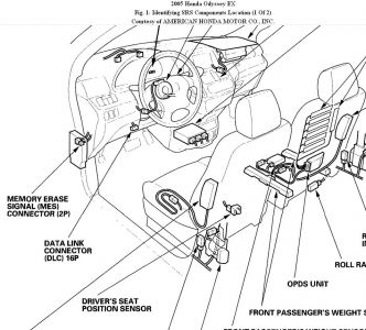

I've found out how to reset the srs light on the internet, but I can't find the mes connector on my odyssey.

I think you may have responded to the wrong question. I'm just looking for the mes location, or am I missing something? Thanks.

Hi hsnitz, Hope the diagram is helpful.

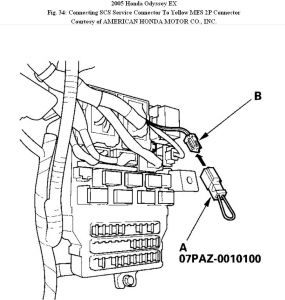

...thanks. I'd found the region, though, just don't know which connector it is. Why I asked if it's always yellow. Is there an easy way to identify the beast?
My plan then, assuming the procedure is the same as on earlier models (resetting using a paper clip, etc), I would try that. Sound okay?

It is yellow and plugged into the fuse box. The manual erasing procedure is similar to earlier models.
